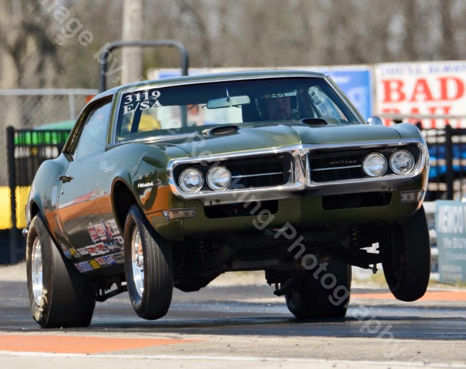

Well, had a great Saturday, last weekend... First time out , for the season, picked up the win in SPortsman class... car ran best of 11.49, on bias slicks... went 6 rounds, for a final 11.49 heads up race, with ex stocker guy, Jerry Long, in his 69 Camaro... it was awesome... headin to INdy divisional this coming weekend...Had a gig last night, so, no racing, but ready to hit it again!~
