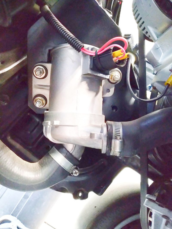

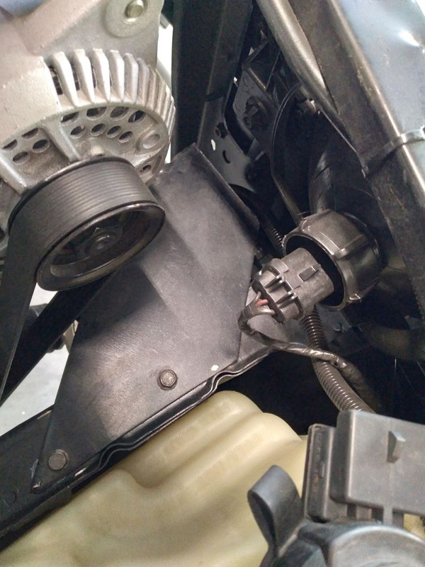

This one is the water pump brackets, and yes , i owe you a finished picture, which i will do soon.

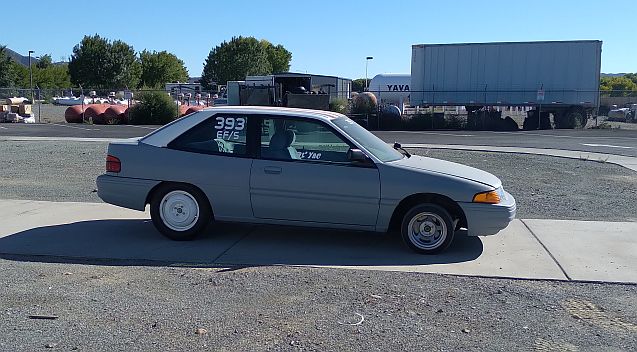

Quick update... Going to test and maybe bracket race this lil' honey Friday, Saturday @ Tucson.
I was able to gain access to the computer through the help of (new national record holder) Robin Lawrence @ Holley. Hoping for lots of improvement here.
Might even be ready for our Combo series early next year, if we get some dates confirmed.
BTW , If anyone is looking for a stand alone system for S/SS ,I'd recommend Holley.
Others may be "fast" but Holley's service network is second to none.
I lowered the rear end some more.The tire difference was making to look too weird for my taste.

"This one is the water pump brackets, and yes , I owe you a finished picture, which I will do soon."
https://i.postimg.cc/j2TgqJSk/20210707-191923.jpg
https://i.postimg.cc/Y026yN9k/20210707-192218.jpg
