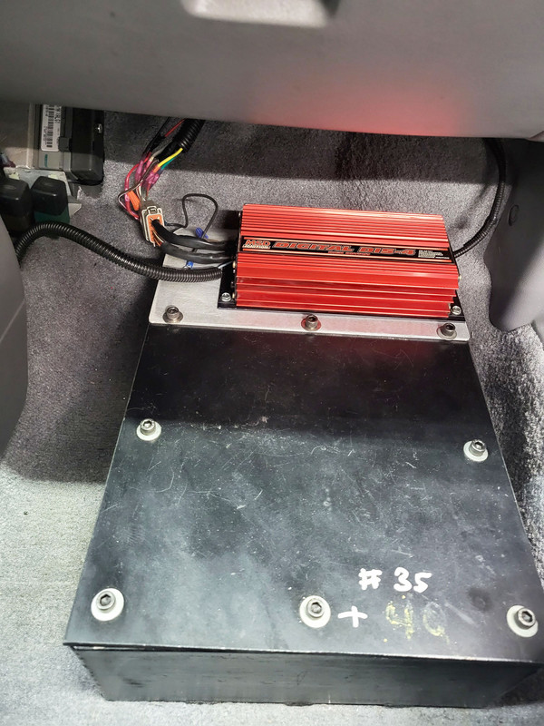

Okay, so thanks to another Racer and CR classifieds, I got my hands on an MSD that's compatible with the multi - port coil, wasted spark deal, such as mine and the Grand National Buicks. So , for the first time in two years, I'll know what RPM I'm leaving the line at.

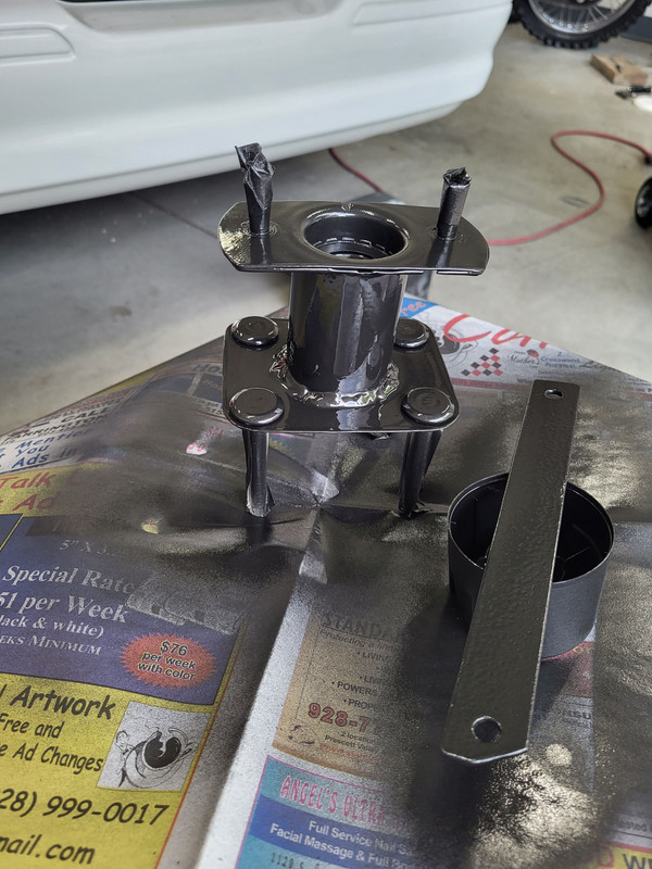

I re-worked the brake system by eliminating the power brake booster, the diagonal brake system, and all proportioning valves. The original P/B system worked too good, with the stock camshaft, making it very hard to stage with just a bit of line lock pressure.
I had to drill the brake pedal and move the pivot up a bit, to get the leverage I needed.
It's all good to go now.

I am at exactly the place you were before your PB to manual brake conversion (except stepping back a step, and swapping out the cam back to a lower lift and overlap/duration numbers, and restoring my PB system to operate better and improve the bottom end numbers a lot without affecting the top end much, at least until November when I can pull the transaxle, freshen it, and send my converter in to be loosened up a bunch, and collecting the parts and pcs necessary to do the full PB to manual brake conversion plus add the 80's Mopar SLH II or SLH III larger conversion pcs. at the same time.
But, I really love the mount you made for your master cyl.
If I provided my orig. stock booster to get the accurate bolt hole center measurements from directly, is there any chance I could request & convince you to fab up another duplicate for me please sir?

Definitely am not in a hurry here, it will take me a while to collect all the other parts for the SLH II or SLH III mopar brakes upgrade, and not thinking about starting to make any conversion until after November. Transaxle will be coming out then, freshened, and Converter sent off and at that point I can stand in the hole, do my Holley engine harness, and then start the conversion, probably Mid December or so before I would even need an approx. length of what the finished mount would be plus or minus an inch, and I can mock up and hang the master and run my new lines, and get my pedal geometry correct, pretty much the last part I would need.
The old cannister would not need to be returned to me, as I just installed a new one, any Auto Zone would refund a core charge also if dropped off when no longer needed or trashed.
If you do come up this way to Vegas. I will give it to you then. If not I will get it to you (along with a ck), and whenever you have time, I would really appreciate it!
