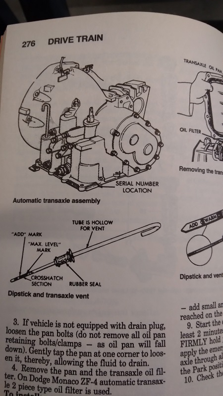

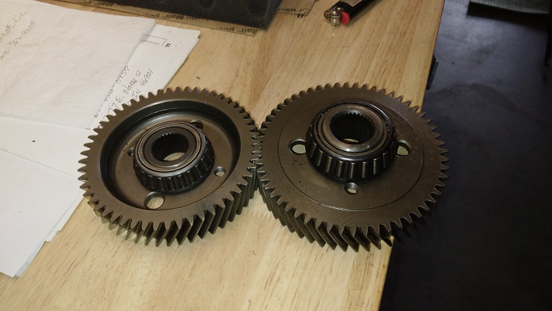

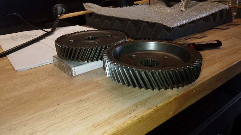

Interesting, on our Mopar FWD vehicles (A413, series transaxle, lots of other numbers involved), there is no chain, just a set of side case gears that mesh w/ one another, that help lower or raise the final ratio. See the pics attached, only so many ratios were factory produced that fit, but it is possible to mill, or mfg different tooth combos to fit. And yes those smaller wheel/tire additions lower the final gear ratio. (Pics to follow, need to resize them first). Then, of course 1st and second gearsets can also be changed, third is 1:1. Then add the smallest wheel tire combo to lower that finial ratio. It certainly helps.

Here are a few shop manual diagrams and pics of my stock side case gearset that came out of my Chrysler A-413 3.21 or 3.22 Ratio back in 1993, replaced, then had a lower ratio gearset cut (once I pull the transaxle next up (soon), I will be counting teeth on those for Greg Hogue to get his 84 Daytona Turbo edition Stocker he is building some info on). Like I said ours are direct drive gear to gear (no chain), but there is always more than 1 way to skin a cat! You may want to talk to him as he is already researching the same thing you seem to be.Attachment 69912
