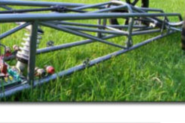

J&S Racing 11-19-2014 03:37 AM
Re: front suspension hard tail dragster
1 Attachment(s)
Thanks Tom, our chassis is already at Mike Bos's shop. Sounds like his setup is a lot like Bills. There a single shock in front of the foot box with a rocker system connected to the axle. (I'll try to post a pic of similar set up from Diamond race cars)Attachment 26405
