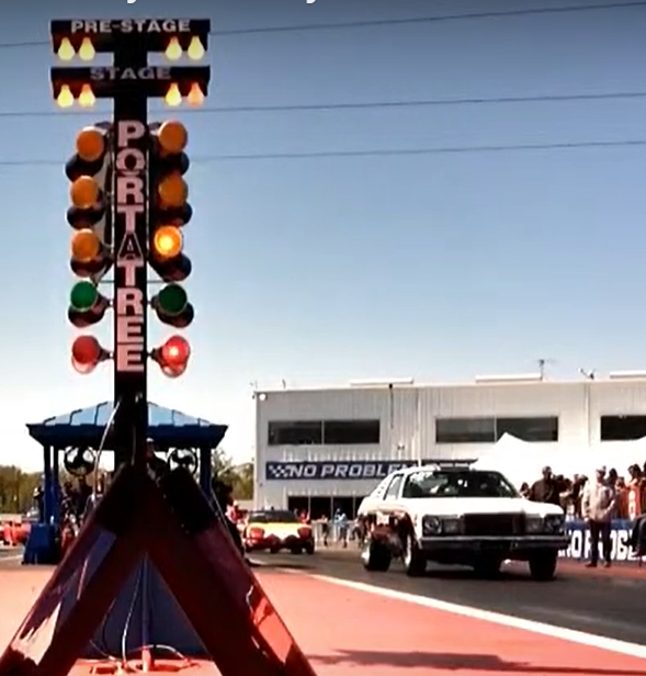

RonB 03-18-2025 07:43 AM
Re: Timing System Malfunctions at No Problem Raceway
1 Attachment(s)
Staging lights and red bulb are all illuminated!Attachment 72271
RonB 03-18-2025 07:46 AM
1 Attachment(s)
Here's a shot from Thursday. The last amber and green lights both illuminatedAttachment 72272!NHRA knew about this problem on Thursday but proceeded to run eliminations anyway and we should all be concerned about the deception. I know Lee Zane lost his class final because of this. Who else got hosed?
