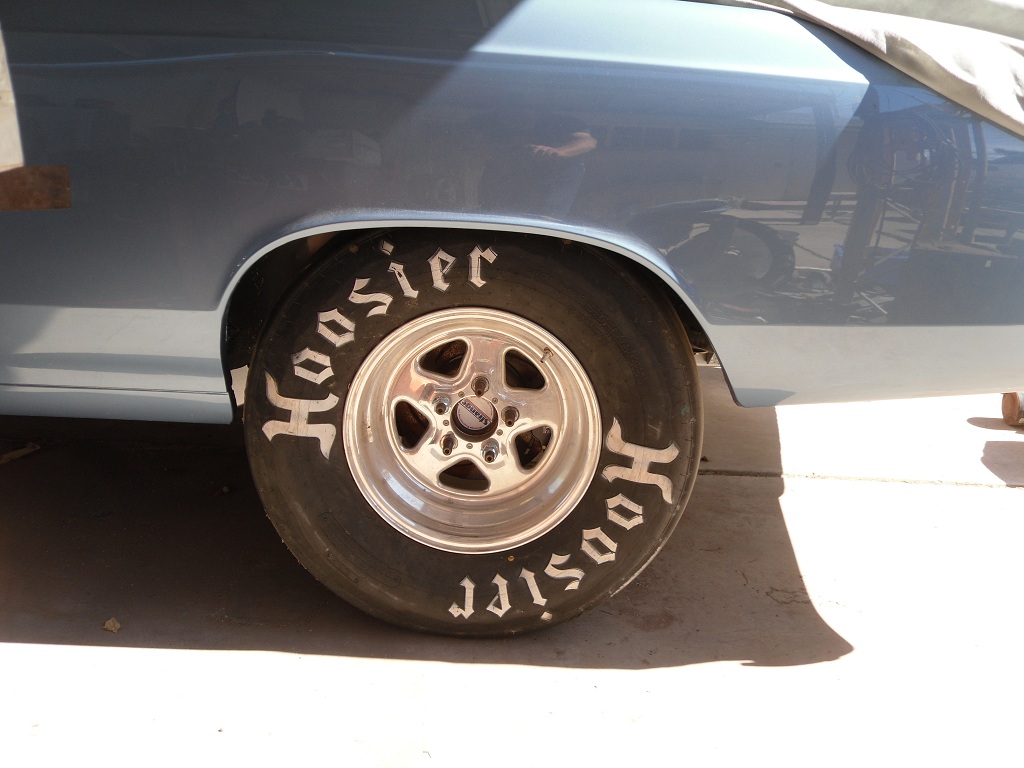

Okay Dave as a Person who has Been There Done that WITH a Stocker with suspension You DO NOT Need to cut outer Body. The Front INNER wheel house MUST BE TRIMMED or it will chew it up on launch and leave. Also Roll the inner Rear to be safe because it can rub. 30 X9 Hoosier Radials and tested with 96" M/T too as well as 29.5 x9 M/T Bias. I have already covered ALL the options you are mulling over. You will like that bar Too.
