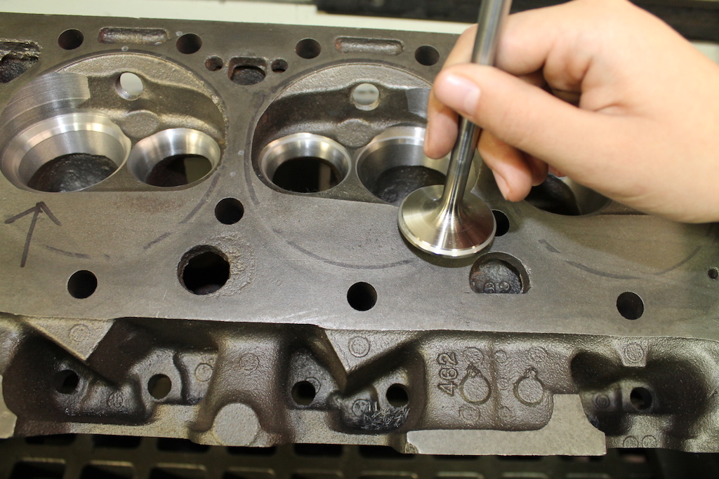

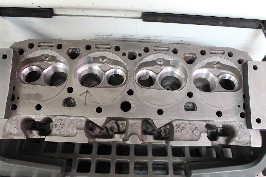

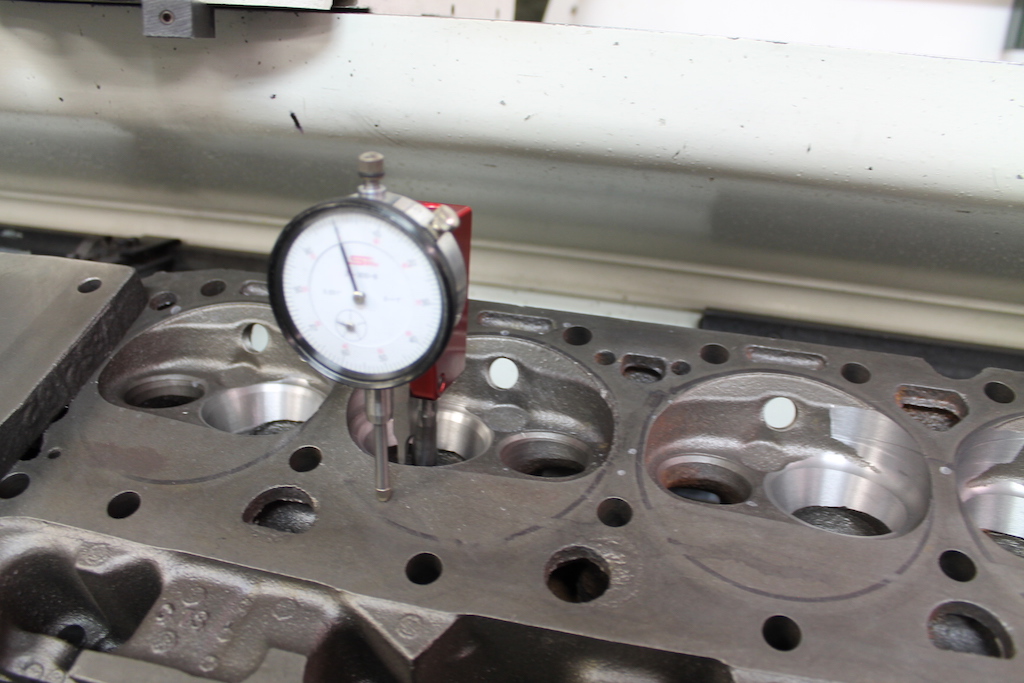

Got started on the heads a while back, machined for screw in studs and guide plates. Installed the guides and honed them to size, and cut for seals. I then started on the intakes by unshrouding the chambers and hogging the bowls for the 2.020 seat. I then cut the intake seat and set height. The exhaust seats were next with the height set.
