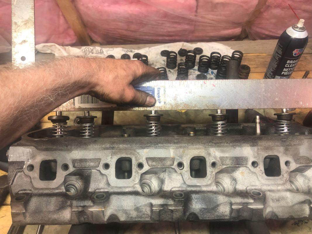

I didn't like how low the 30* seat was so I tried to save it and did! So I got all intakes and exh valves ground and the valve job done.
15/30/45seat/60throat
After that was done I used lite springs to check stem height. Got them all within .012 by trimming the tip. Now I have to work on the installed height.

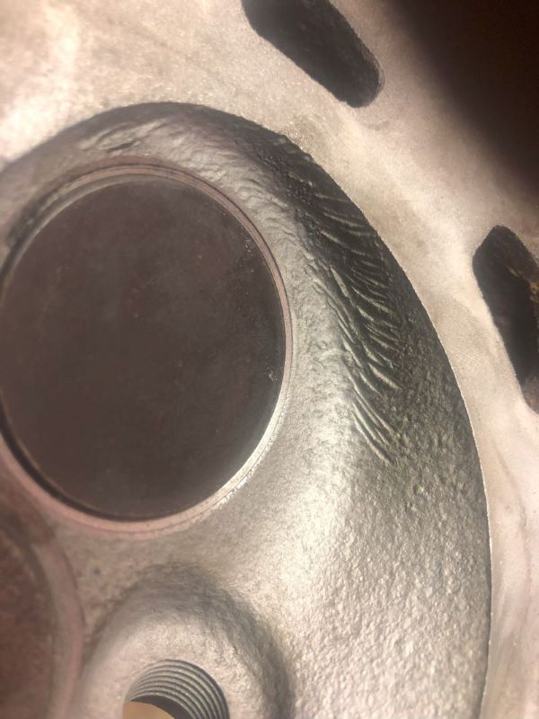

After the heads were cleaned I see this mess in one chamber, not sure if someone chattered a stone or something let go, who knows but how do I fix it or can I fix it since you can't do anything in the chamber?
Still moving forward, so that's good.
