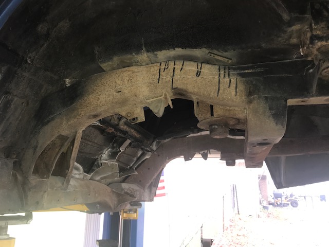

These photos show the "trunk" floor cut out and the OE rear assembly removed, which is the beginning of the of the process.
More progress soon. |
