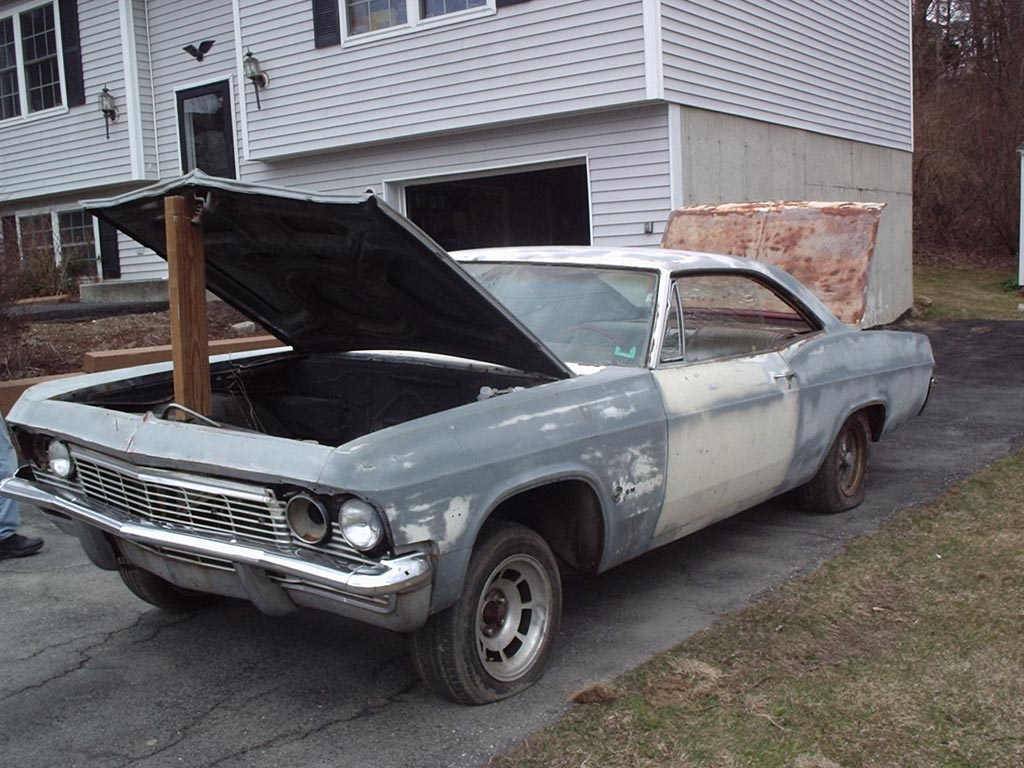

Had a 1968 Impala original 427/425 car with matching #'s, pulled that motor out and built a Stocker with a 396/325 , Jerico and ran I/S at 4095 pounds. ran 11.70's best, but never really flogged it. I sold car to collector who restored it back to the stock 427/425 car, lliks great. I purchased all the race parts back from him, rear end, ignition, motor ect., now i am building a 1965 Impala with the same motor combo to run I or H Stock.

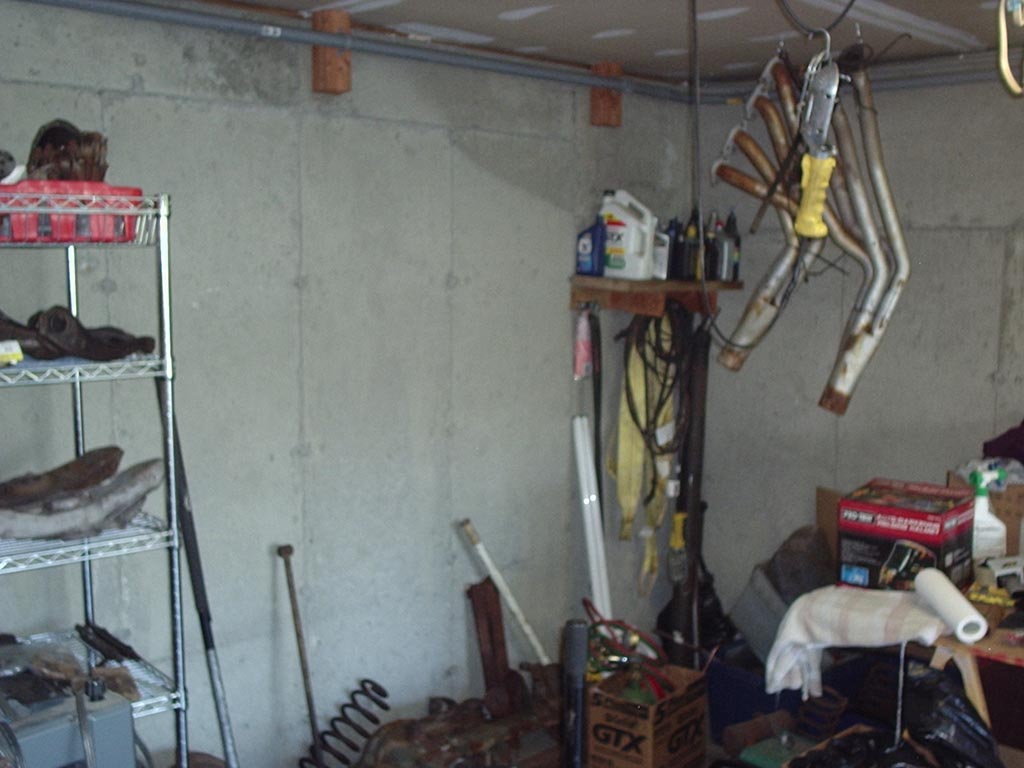

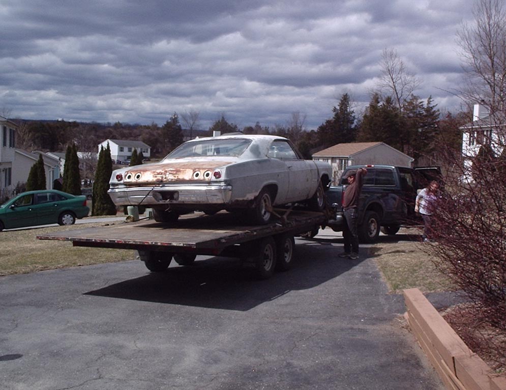

Thanks Billy, my brother Ed ran a 69 Nova in V/SA with the 230 in the eighties with Joe Huestis, Div 1 car, they could never get it yo run like your car though! The Impala is apart, working on the frame. Any input would be appreciated.
Will Lamprecht
Div 1 , Wingdale, NY
ID:	19805   Click image for larger version
ID:	19806   Click image for larger version
