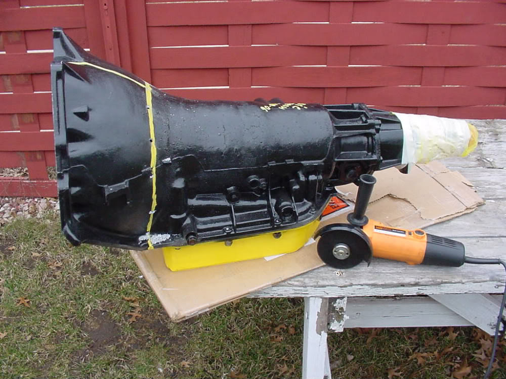

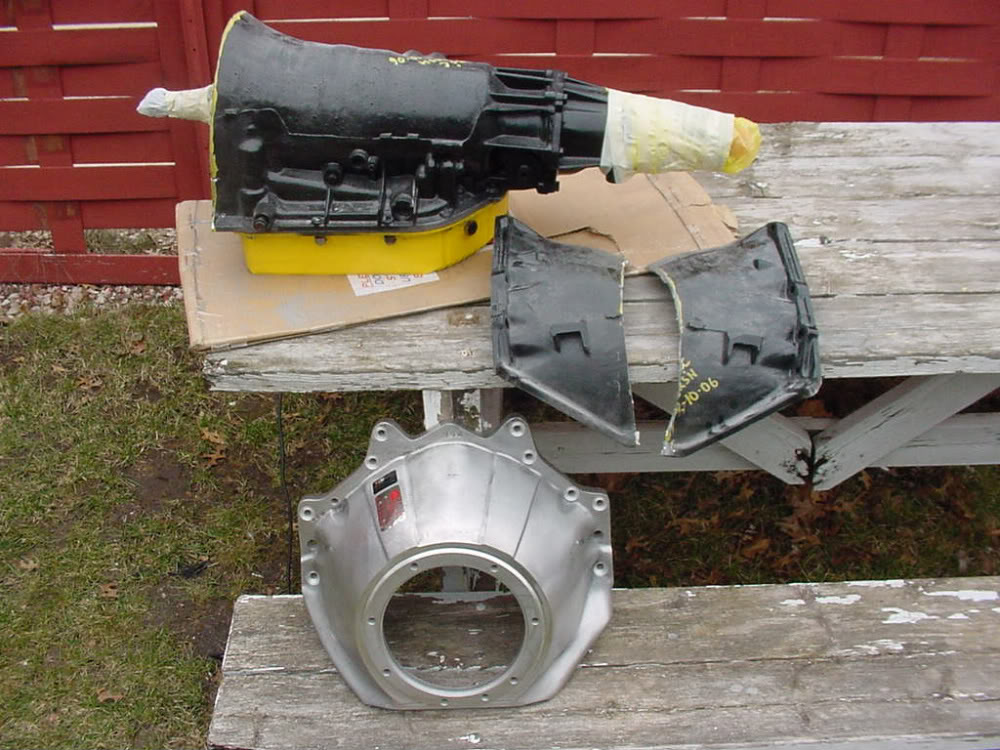

I drilled a series of small (.250") holes around the original bell housing from the inside, as close to the pump as I could get. Then, on the outside of the bell, I drew a line, connecting the holes for a cutting guide. The instructions give you a measurement from the mounting surface of the bell to your cut. Your guide line (holes) should be close to that measurement... I finished off my cut edge with a hand held belt sander, and some 80 grit..
I just masked off any openings in the trans and did my complete install with the trans together..

thanks for the pics Bob.I was thinking of drilling the holes as a guide line also.
