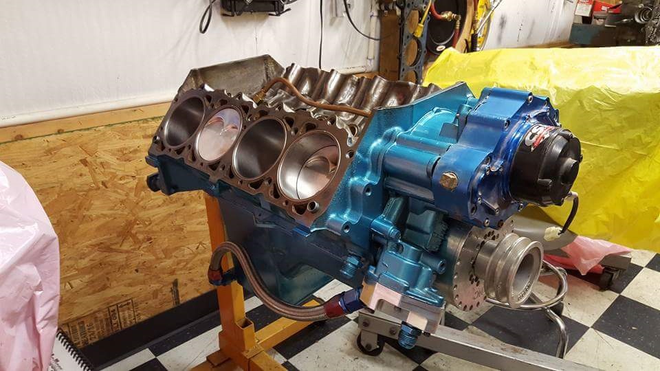

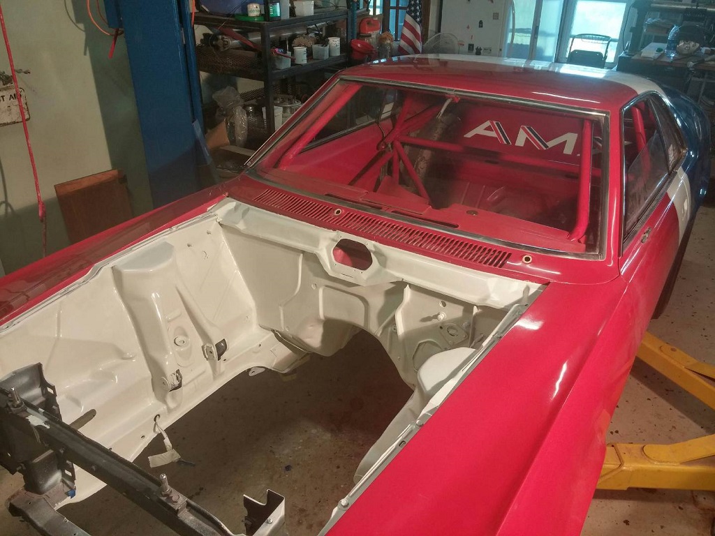

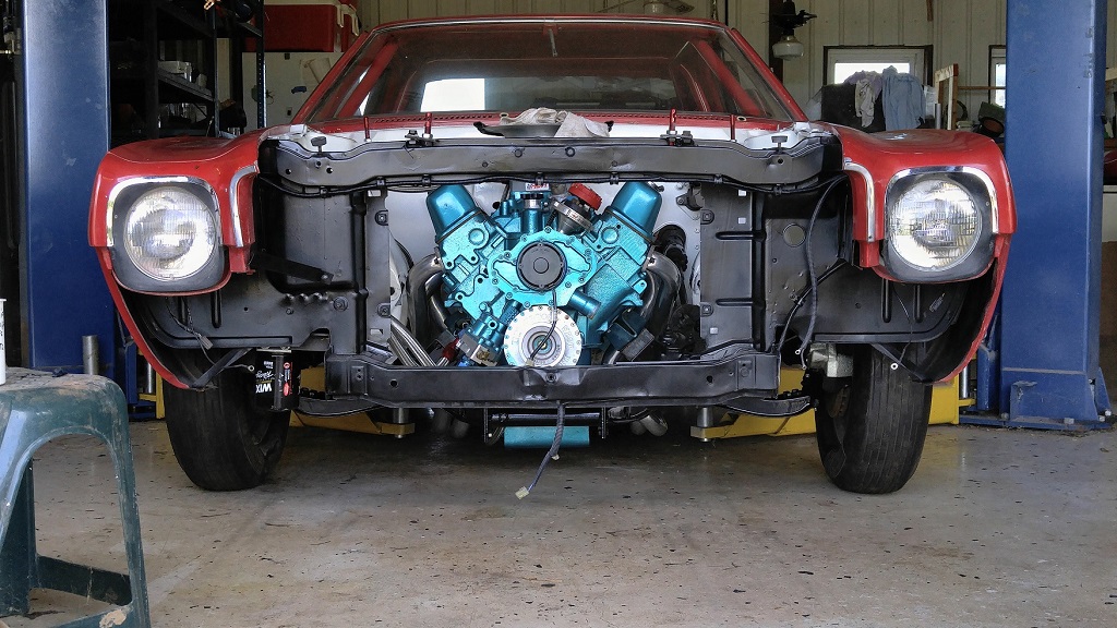

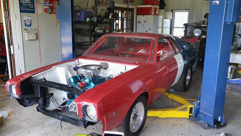

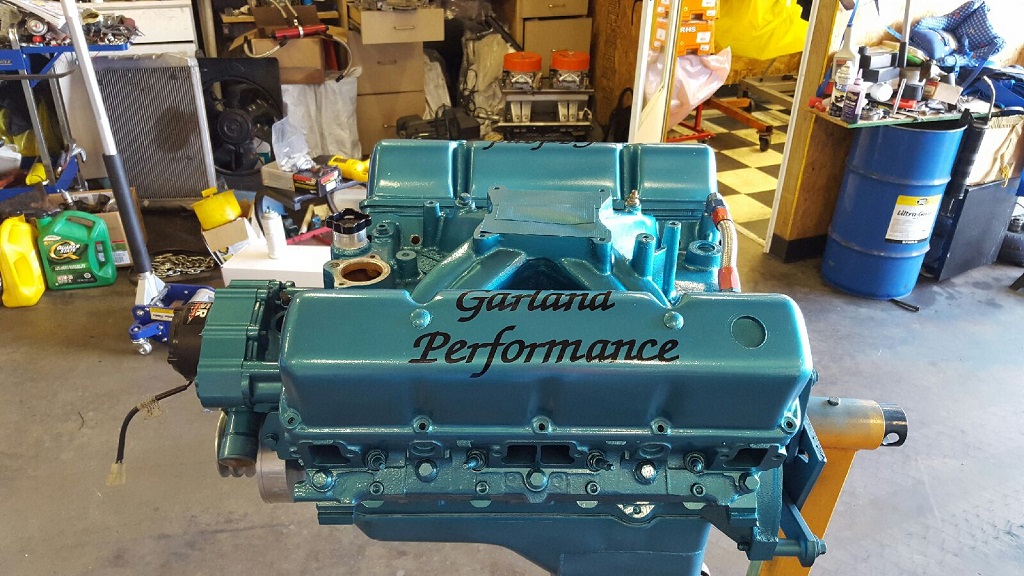

this is the 69 amx that my dad and i are going through it has a new molly 10 point cage painless wiring brand new fuel system and the engine is a 427 inch amc with some professionally ported iron heads and a .740 lift 280@.050 solid roller with about 13.2 to 1 compression and 1050 dominator on e85. behind that its got a 727 with a break and 8 3/4 rearend with 4.10 gears and spool with all calvert rear suspension. no clue what it'll run hoping for deep in the tens.

Clean machine! New car for you guys or is it a gradual re-do of a car you've had a long time?

We've owned the car since 1982. It was origanelly a 343 4speed car. The cars seen several make overs and this last transformation has taken 5 years but is nearing completion. The last time the car was raced it had a 9.5 to 1 390 with a hydraulic cam and 904 with a 3500 stall and 4.10s in the back and ran 11.50s at that time it had a 6 point mild steel bar and stockish suspenion.

The tunnal ram was on A.H. Adkins superstock b car the dominator s are just chilling on top of it. Its actually not ours i forgot that photo was taken at john garlands shop in kansas city.

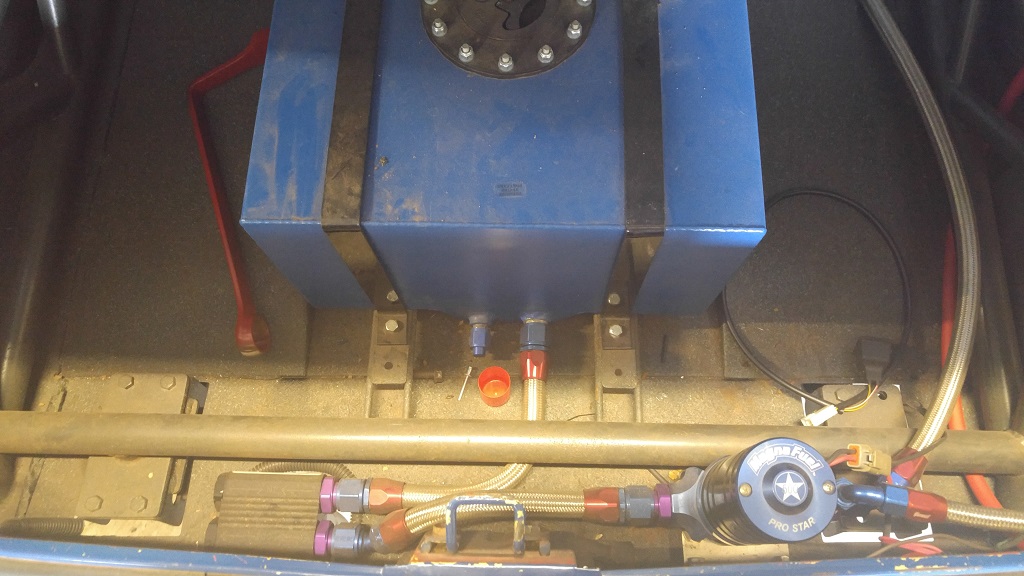

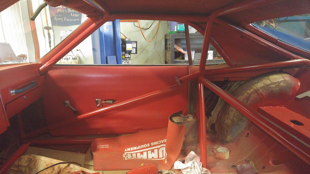

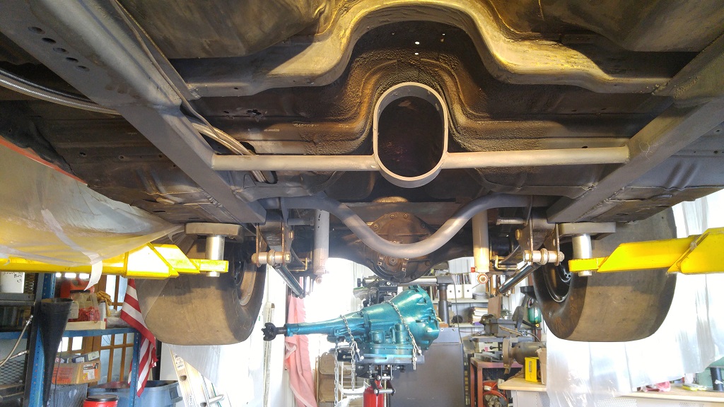

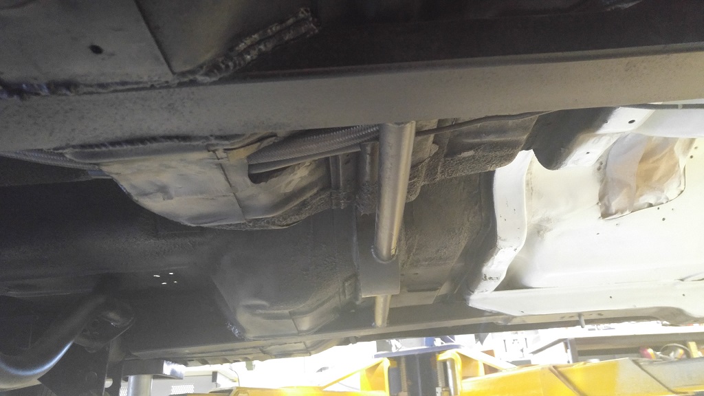

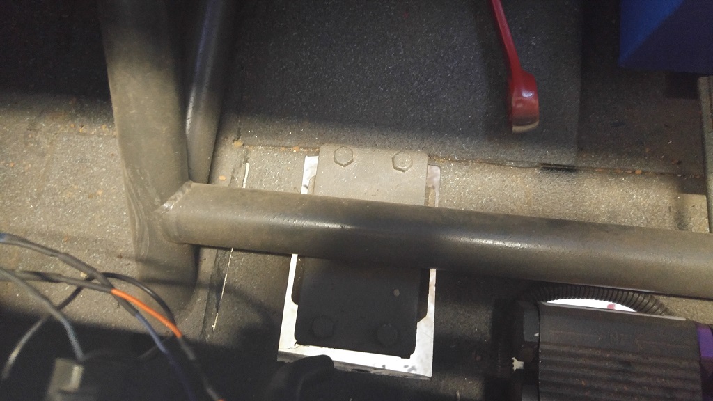

just a couple more picturess showing the cage and fuel system i think its got alot of tubing in it for a mid-low 10 second ride but but i guess it doesn't hurt anything.

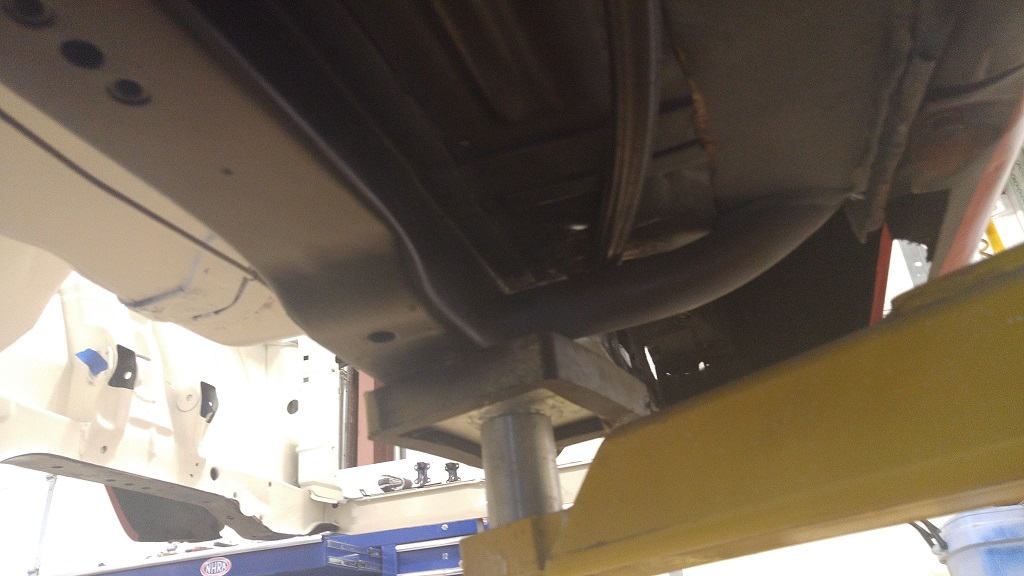

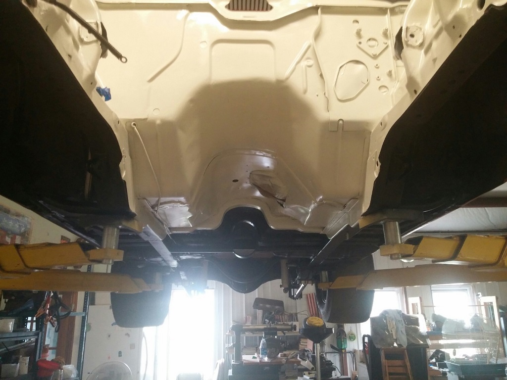

a few more just showing were the leaf spring sliders bolt to the cage figure we could use spacers here to raise or lower the car if necessary. and subframe connectors and drive shaft loop.

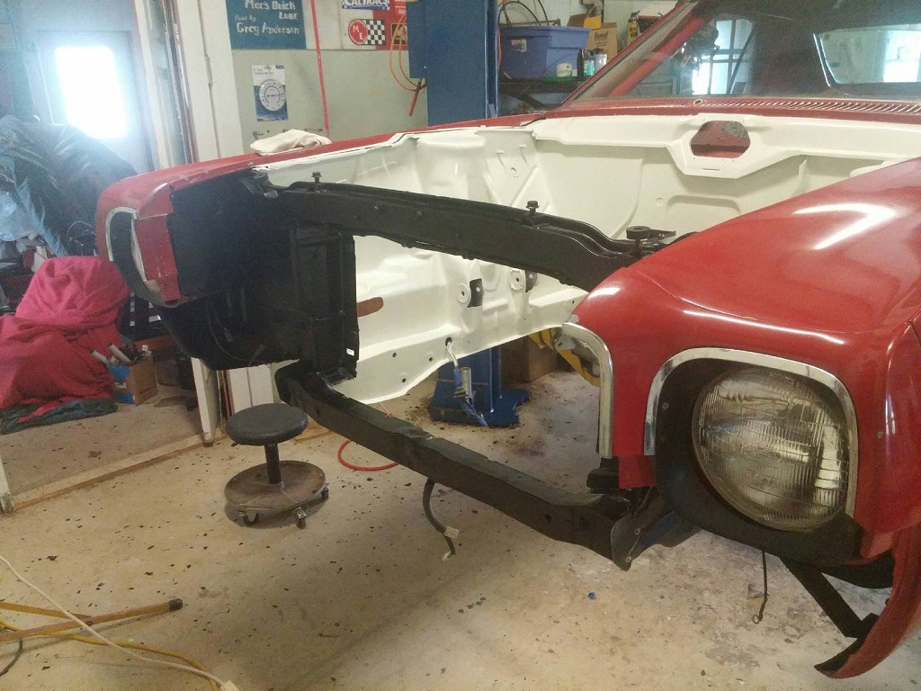

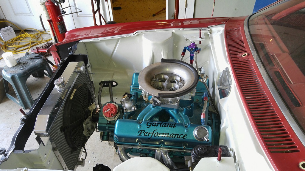

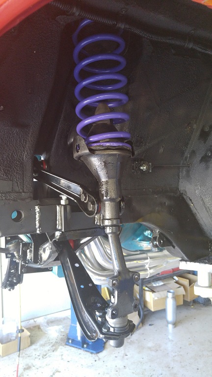

after fixing some trans/converter issues its going together.
