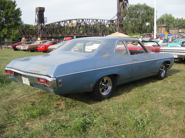

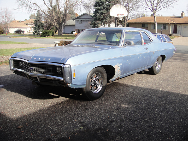

Couple of pics. Looking for a vintage junior stock look.
