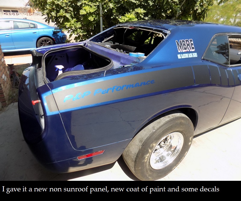

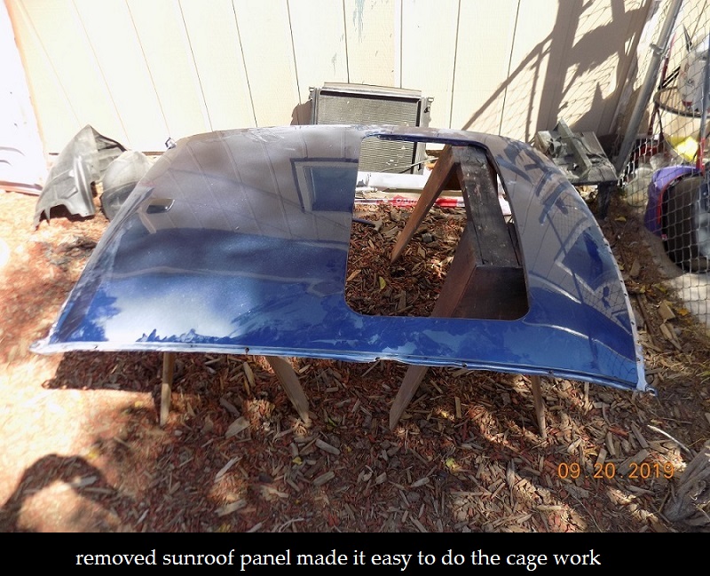

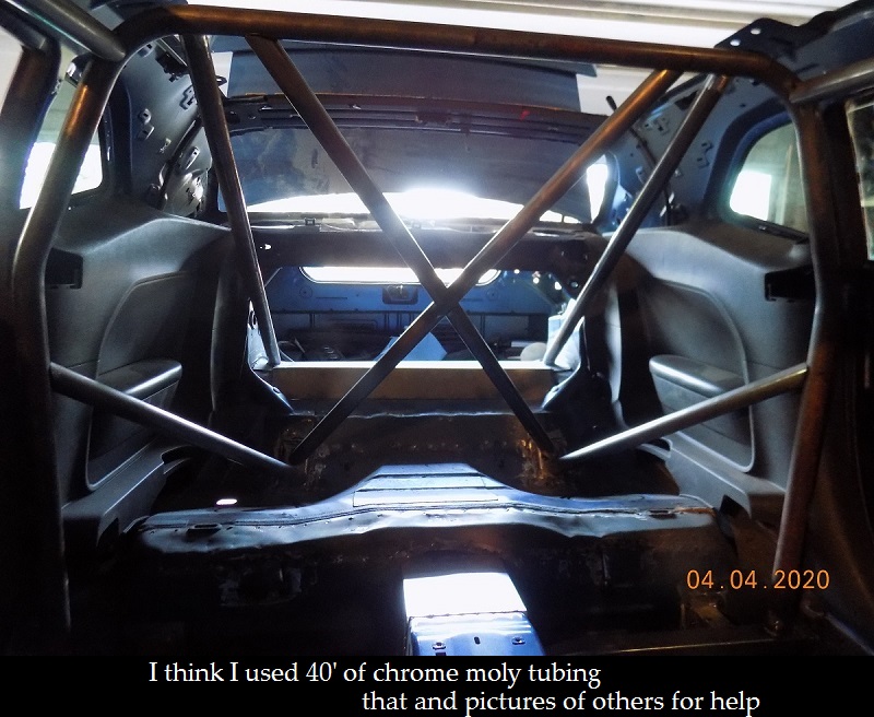

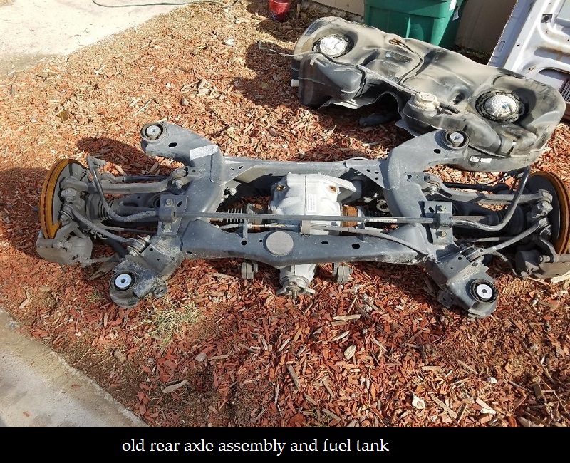

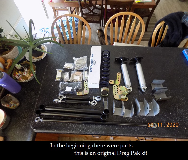

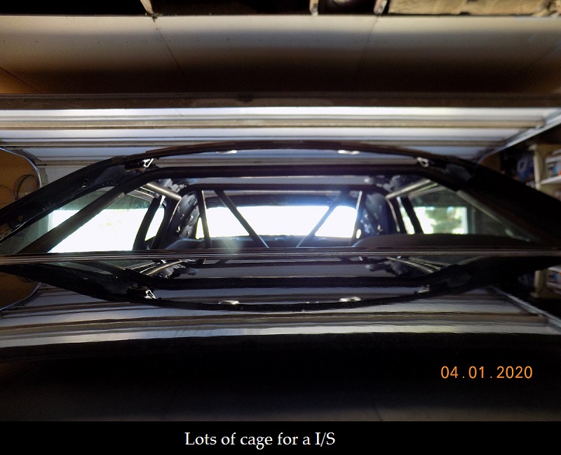

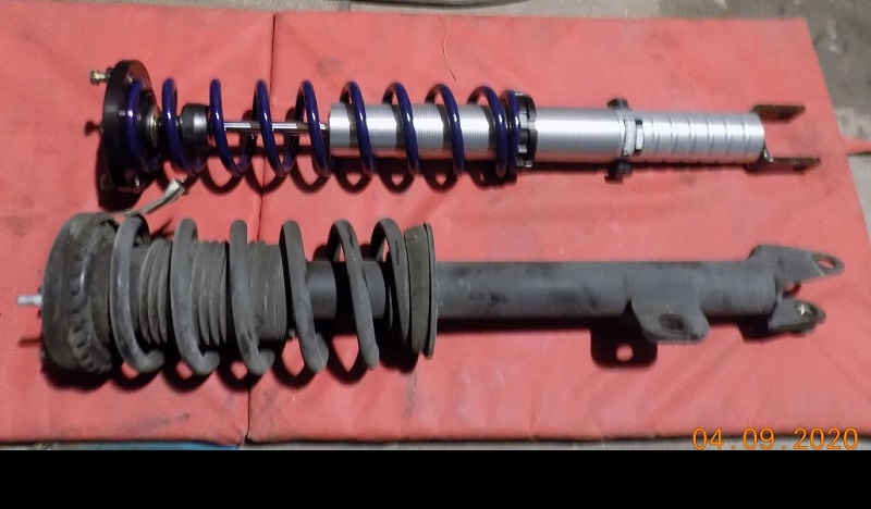

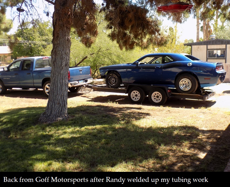

Here are a couple pictures of the project.
Name:	1 car in the beginning.jpg
ID:	63276   Click image for larger version
Name:	2 Old rear end and fuel tank.jpg
ID:	63277   Click image for larger version
Name:	3 Sunroof panel.jpg

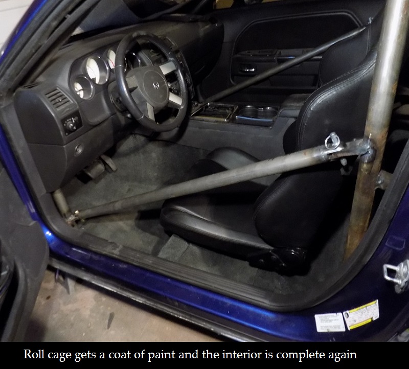

Name:	4 cage work.jpg
ID:	63279   Click image for larger version
Name:	5 car on the trailer.jpg

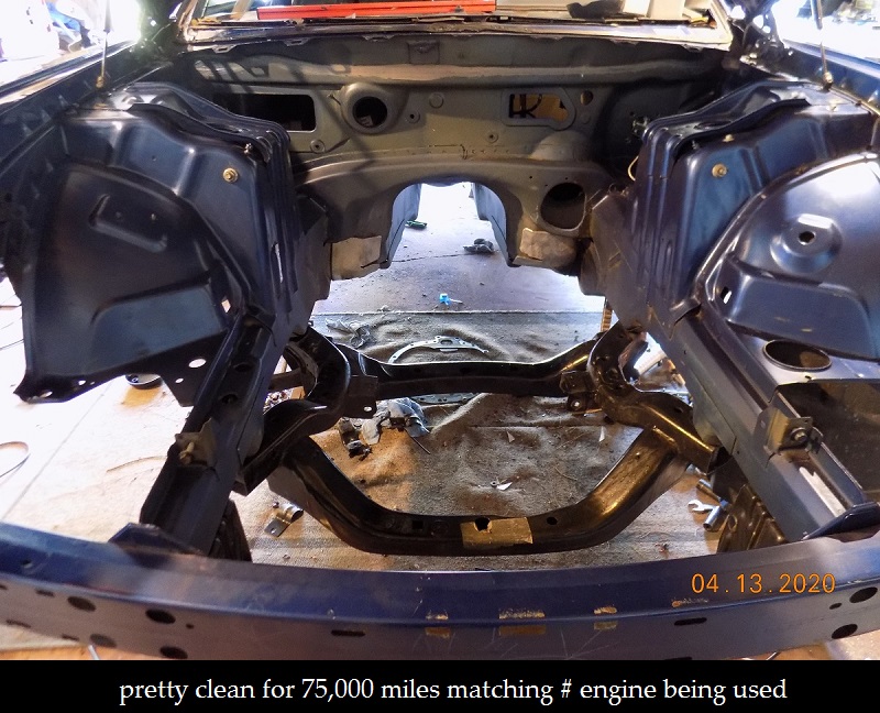

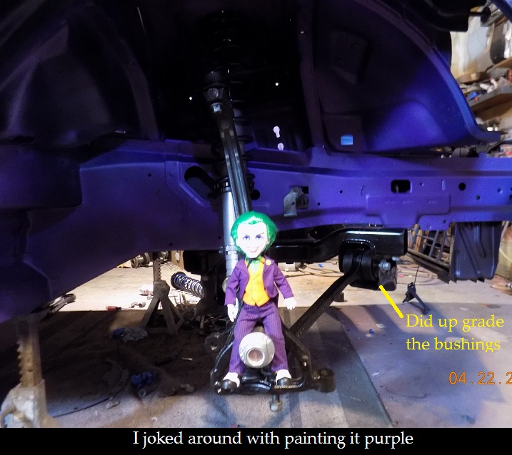

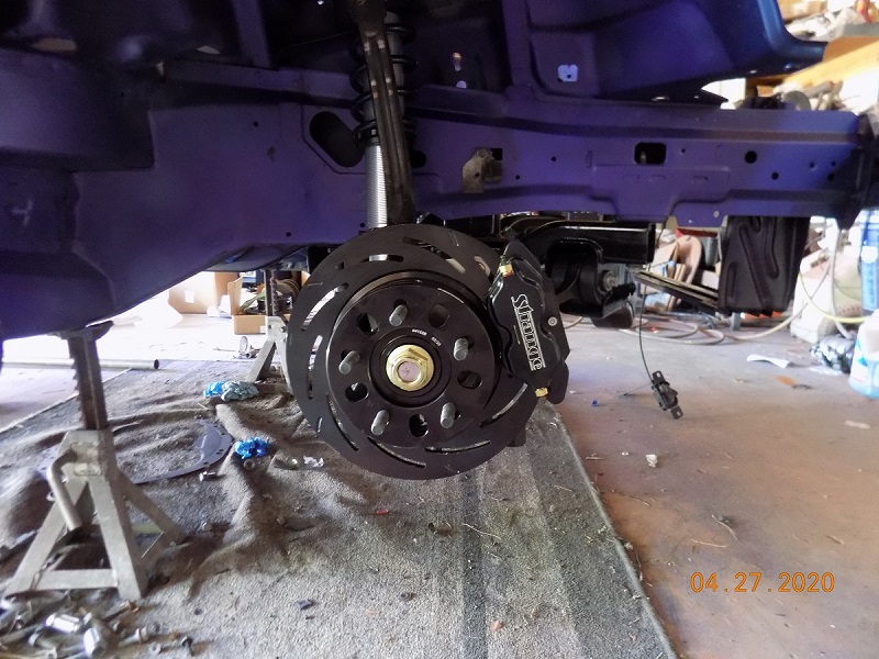

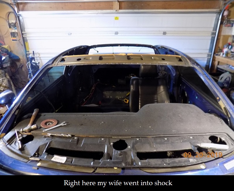

couple more
Name:	5a Roof removed.jpg
ID:	63281   Click image for larger version
Name:	7 challenger Eyebrow.jpg
ID:	63282   Click image for larger version
Name:	8 front struts.jpg
Name:	9 engine compartment.jpg
ID:	63284   Click image for larger version
Name:	10 front brakes.jpg
ID:	63285   Click image for larger version
Name:	12 anti roll bar mounted.jpg

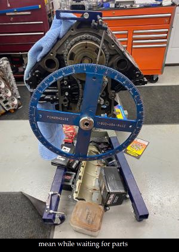

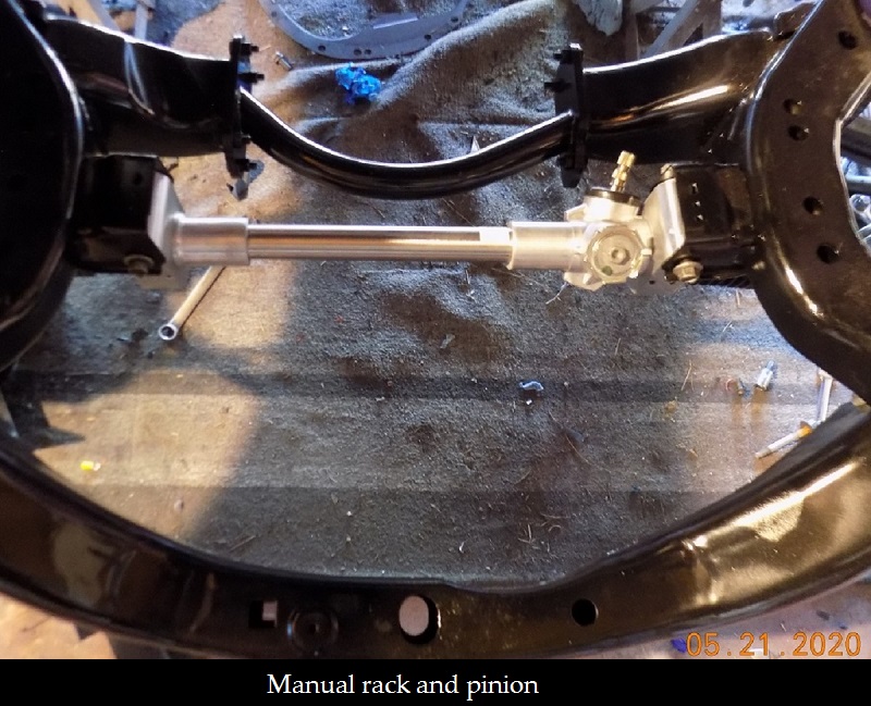

Name:	15 degree.jpg
ID:	63289   Click image for larger version

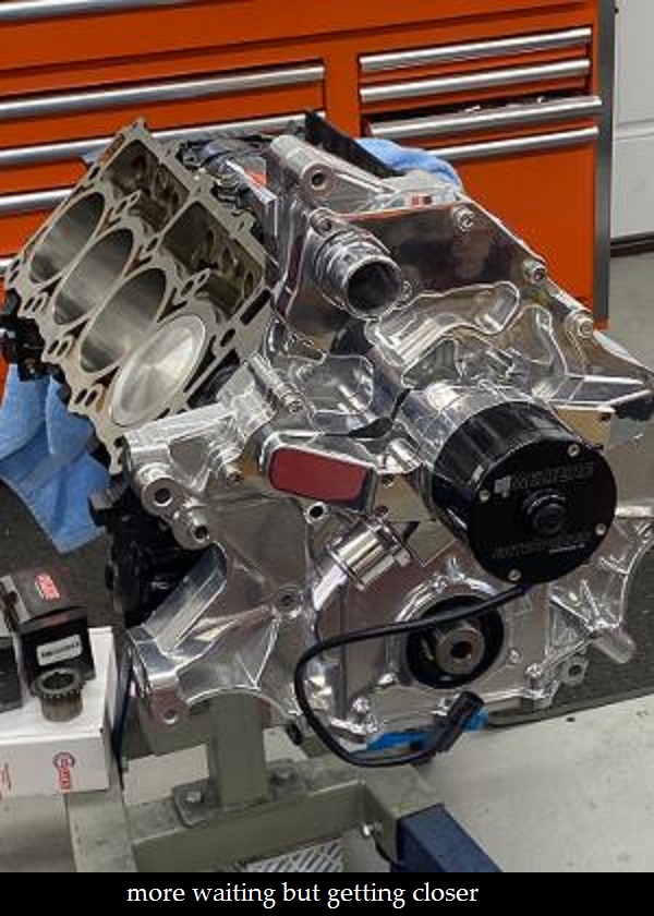

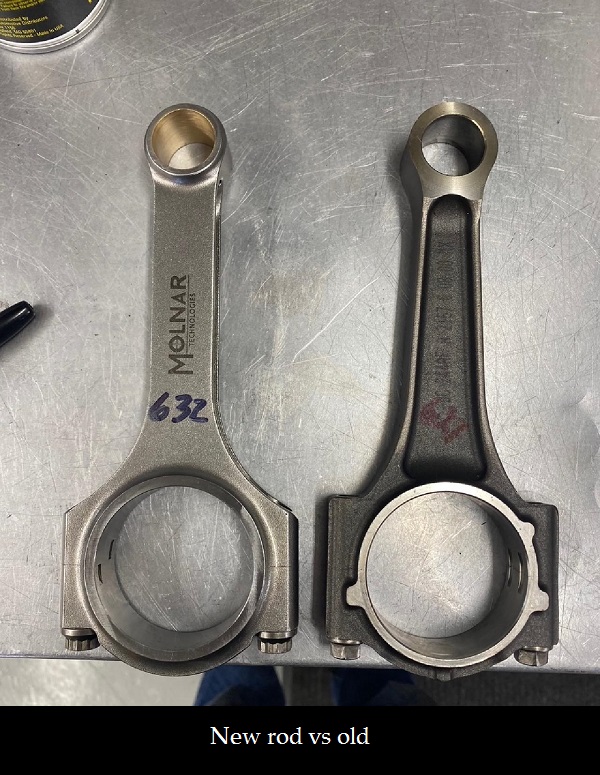

Name:	16 water pump.jpg
ID:	63291   Click image for larger version
Name:	19 New rod.jpg
ID:	63292   Click image for larger version

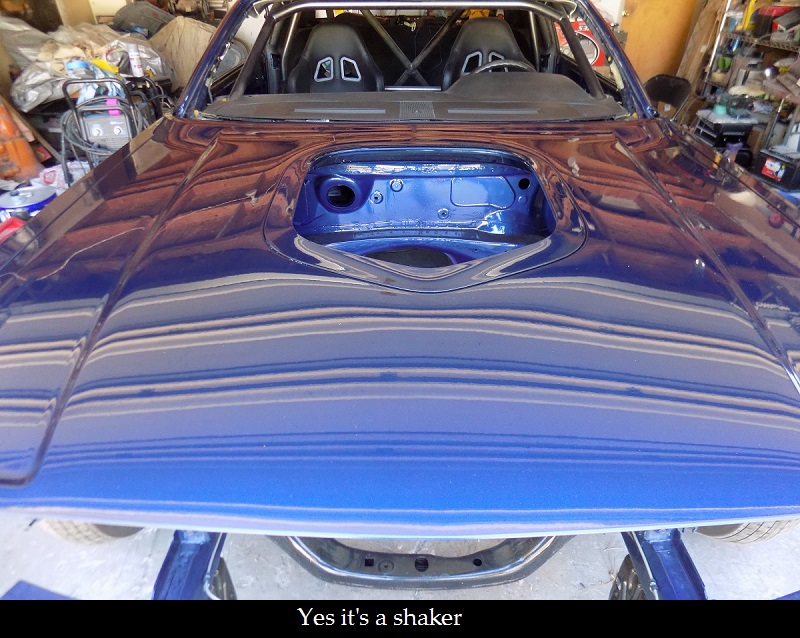

Name:	22 shaker hood pt.jpg

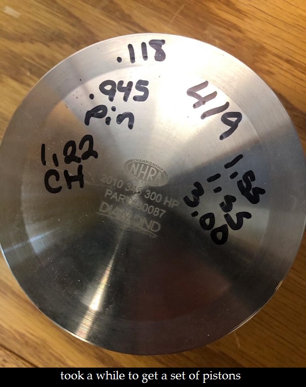

Paul
Name:	17 excepted piston.jpg

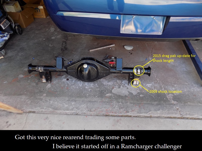

ID:	63294   Click image for larger version
Name:	23 rearend parts.jpg

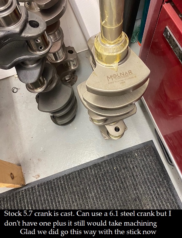

Name:	24 New crank.jpg

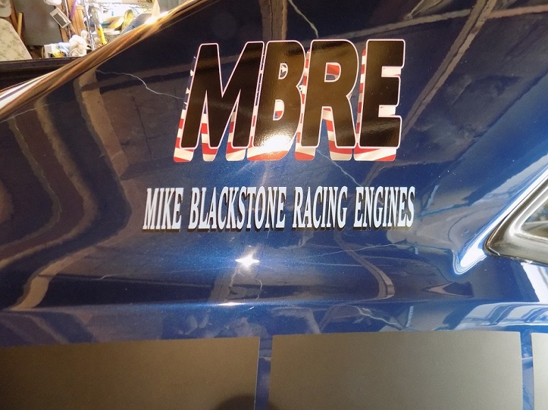

Default Re: 4 speed set up in a 2013 Challenger

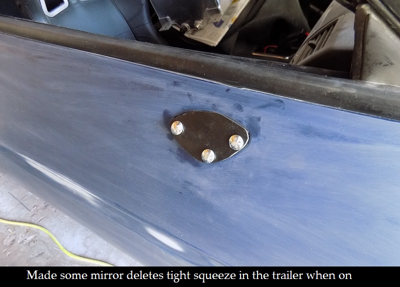

all the little things
Name:	26 right mirror delete.jpg
ID:	63309   Click image for larger version
Name:	27 rearend.jpg
ID:	63310   Click image for larger version
Name:	28 right front suspension.jpg
