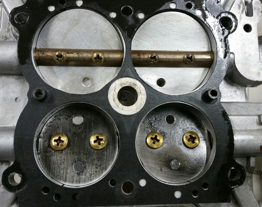

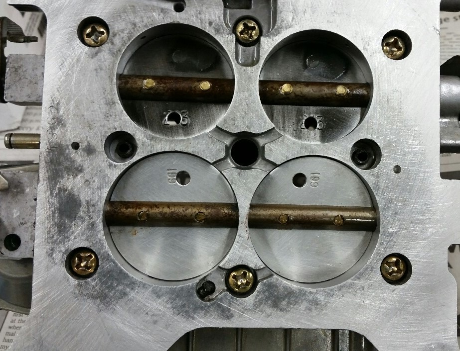

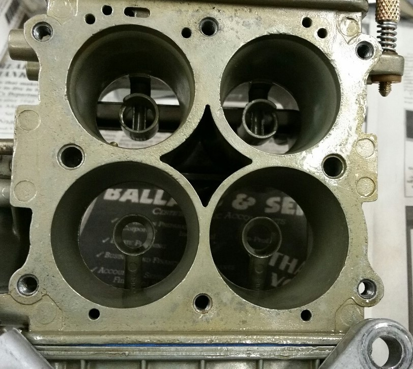

Default Fuel in intake
Has anyone seen this ? I have a 383 mopar stock engine and have been getting fuel fouled spark plugs and I see fuel on the plenum floor of the intake. It's dual plane intake, fuel is on both sides. I've been working on the carb (holley) thinking too much of the transfer slot is exposed. The heat passage is blocked, so I'm wondering is the fuel puddling up because I've blocked the heat passage which not letting the fuel atomize ? I thought I had fuel in the oil,but I had it analyzed and they didn't detect anything. I was thinking about putting hotter plugs in it and maybe that would burn the fuel off. any experience ??

I've tried that Larry, not a drop. fuel pressure at 6#. When the engine is running, I can look down and nothing is coming out of the boosters. But when I take the carb off, the top of the base gasket is always wet. It's a 4 hole gasket to match intake. I'm missing something..

I don't have another good carb to try. Accelerator pump is 30cc, PV is 2.5. This problem happens after just idling. I have a plug for the PV, yet to try it though. I guess I'll try to map out all the passages next. Also will post some pics.
