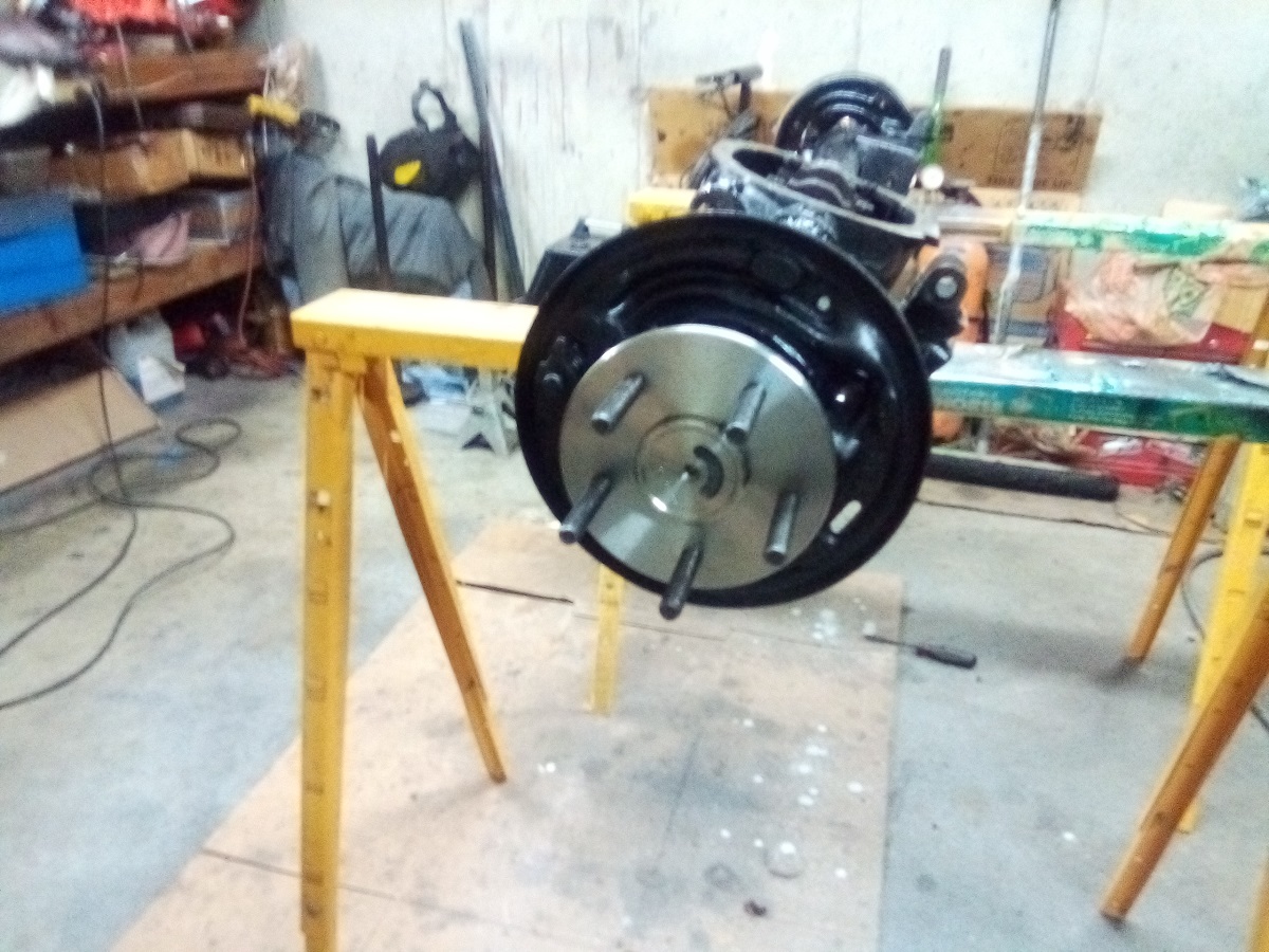

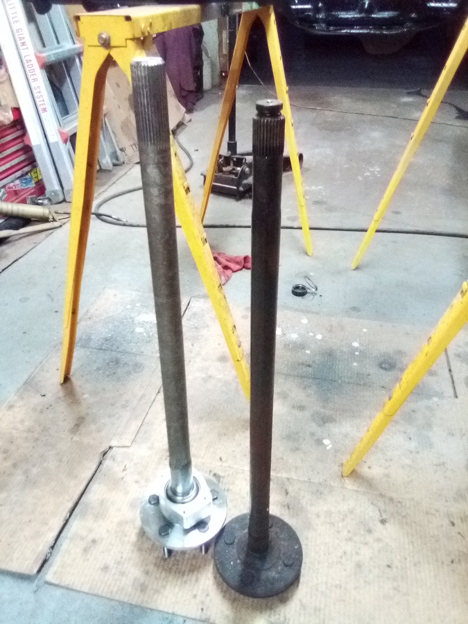

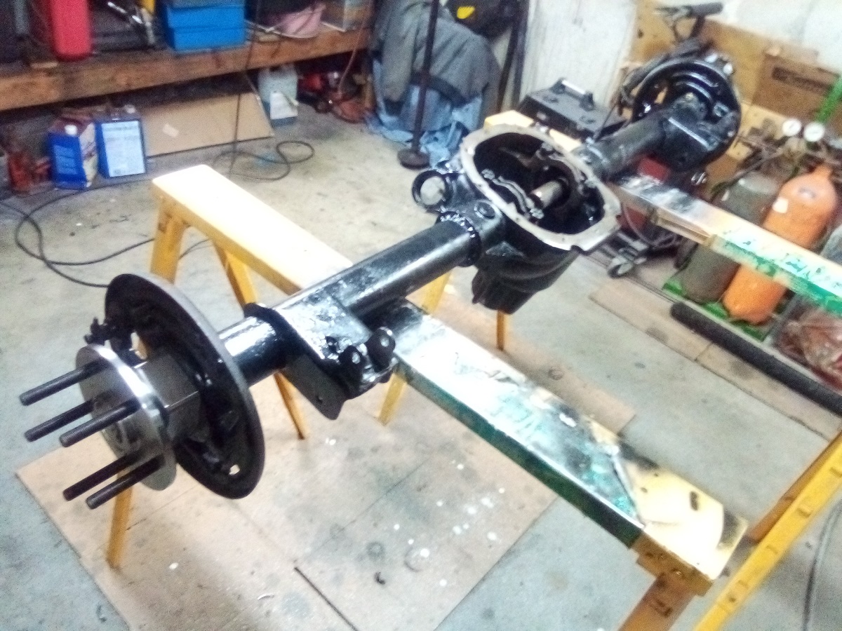

Work in progress with rear.
ID:	53391   Click image for larger version
ID:	53392   Click image for larger version
