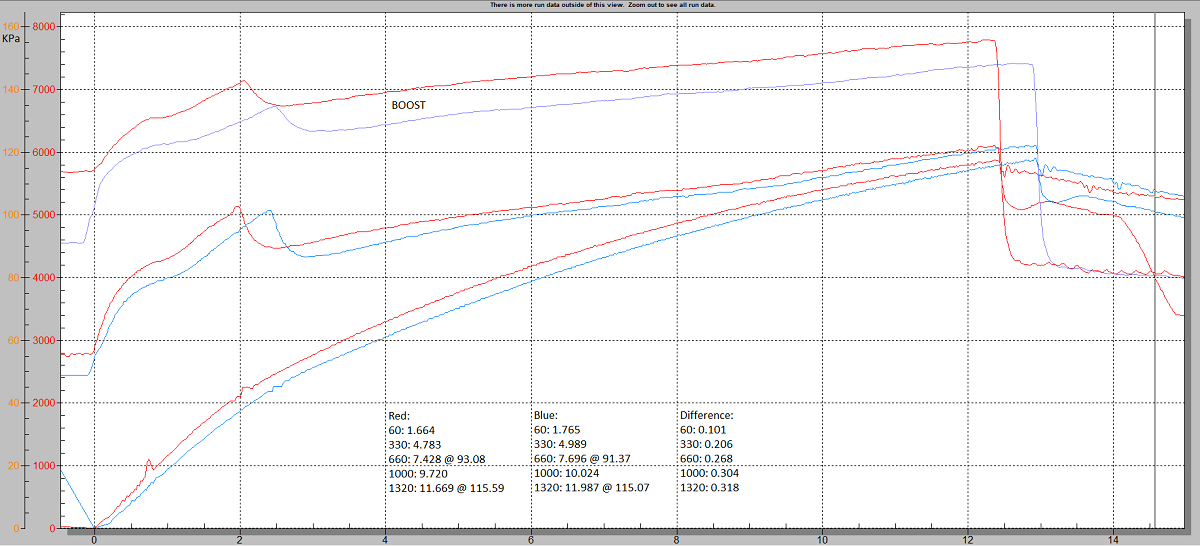

Right now I'm slipping 15% at the 1/8 and 5% at the 1/4. In February I went 7.41 and this weekend I went 7.49, both on the 3.70 pulley. So weather doesn't seem to affect it much with the EFI.

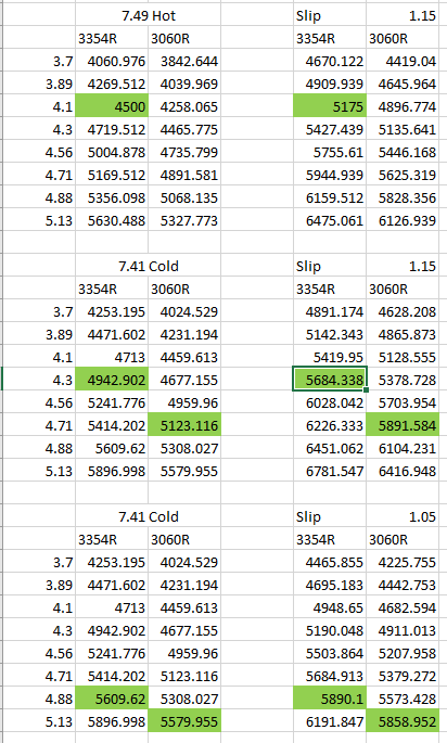

Based on my math, 5.13's would compliment the taller tire if the slip stays at 5%, but 4.71's if it stays at 15%.
How do converters typically react after a gear change? In my mind, as long as the driveshaft RPM and power output are the same, then engine RPM should be the same, regardless of track length. But does reality follow this or another direction?

For the table, the left stack is driveshaft RPM and the right stack is engine RPM. I used the truth numbers from the logger for 4.10/3354R and extrapolated the rest of the data.
ID:	68228   Click image for larger version
