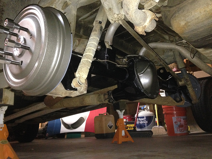

Building a 69 Bel Air 2 door sedan, mainly for bracket racing because I could never afford a proper stock class campaign. Right now the car is stock, has a 2bbl 327 and TH350. I removed the greasy 10 bolt last year and installed a 4:11 12 bolt. I have a TH400 core for building. Also have the basics for a decent oval port 454.

Couple of pics. Looking for a vintage junior stock look.
