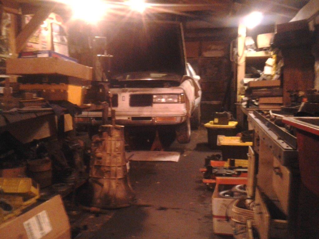

Hello, my name is Chris Lindell, and I am a newbie to class racing. I am building a 1987 Olds Cutlass Salon to compete in IHRA I/PS.
My goal is to see how far under the index (14.55) I can get with a combination most people consider junk and throw away.
307 cid engine
200 metric trans
7.5" rear
I am also very cheap by nature, and do not like spending a lot of money on this stuff. It will be a fun challenge!!

Understand your POV.
Racing is not cheap..
However the car is the least expensive.
It is the travel, pit fees, and motel.
The 307 is very popular especially with a QJet.
Your rear is strong enough, parts are available.
Engine, Trans, rear, and converter with be your largest investments.
Ping Billy Nees...

Send the money to venolia for replacement pistons - you cannot due without them! 4.56 in the 7.5 is plenty. Have fun

LOTS of G body stuff here:
http://www.maliburacing.com/
http://gbodyforum.com/index.php?sid=...b#.U3p6K5VOW00
If you are cheap (isn't everyone?) you will find interchange info for 7.5 gears-rearends-steering-suspension and more.
