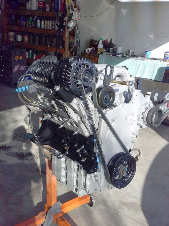

Okay..It's a 2003 3.4 60 degree Chevy V6 LA1 option (207 ci)
Not a totally original idea, but first in this body style and weight, I believe.
Before I forget..Blueprinted NHRA spec heads by Kadar Performance ..

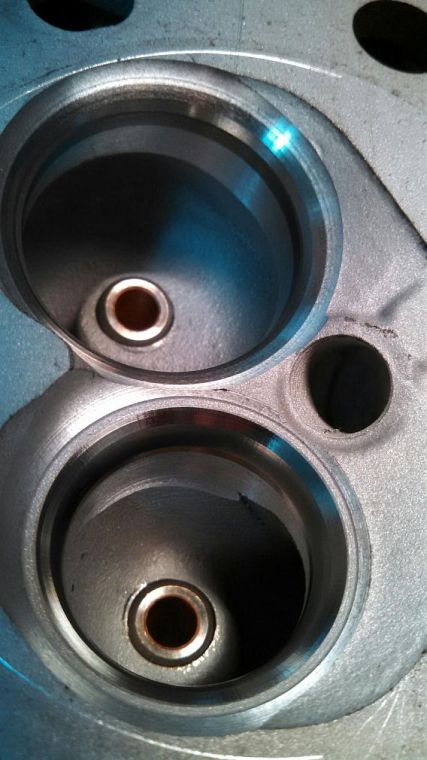

We have a family connection at Kadar Performance, so I don't know the pricing, but actually these heads needed to be straightened out anyway. Someone did a "valve job" on them last year,and carved them up pretty bad..Had to throw the valves away.
These heads are literally laying on the ground at the U pull it yards.
A little 3 angle , mill for cc's, and pop some new Comp beehive springs on them, and I don't believe they'd be too bad.
