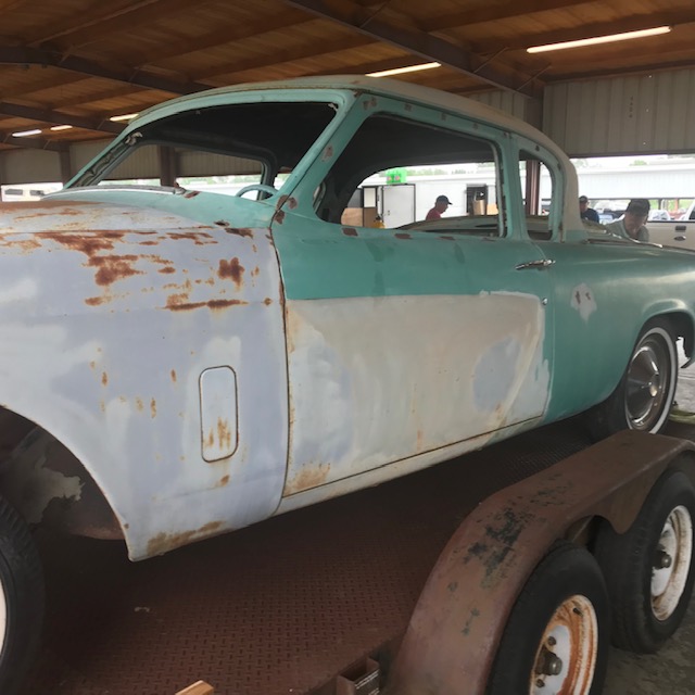

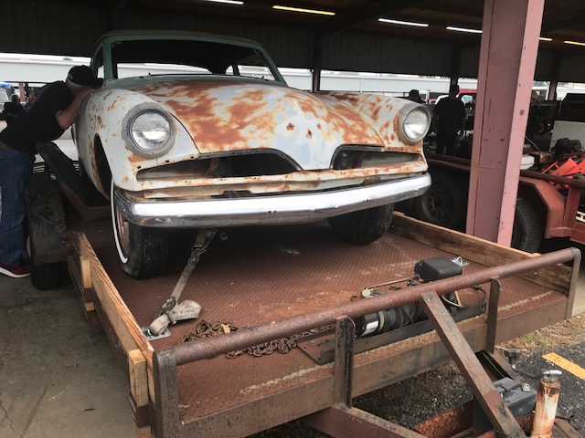

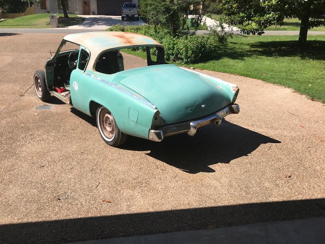

The StuFin core
ID:	64212   Click image for larger version
ID:	64213   Click image for larger version
ID:	64215   Click image for larger version

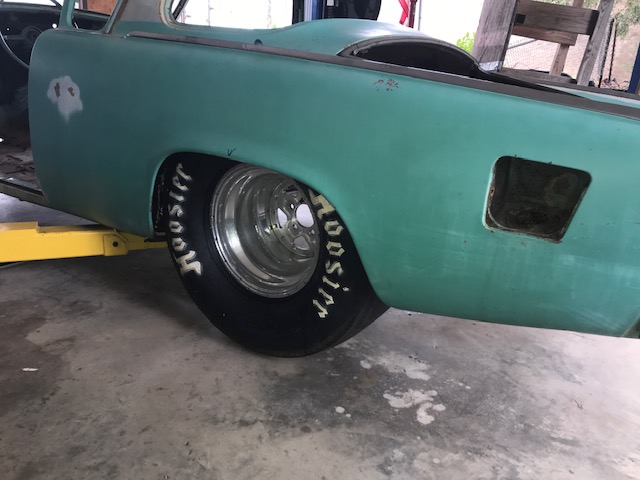

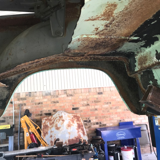

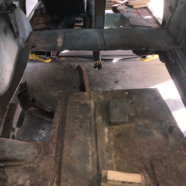

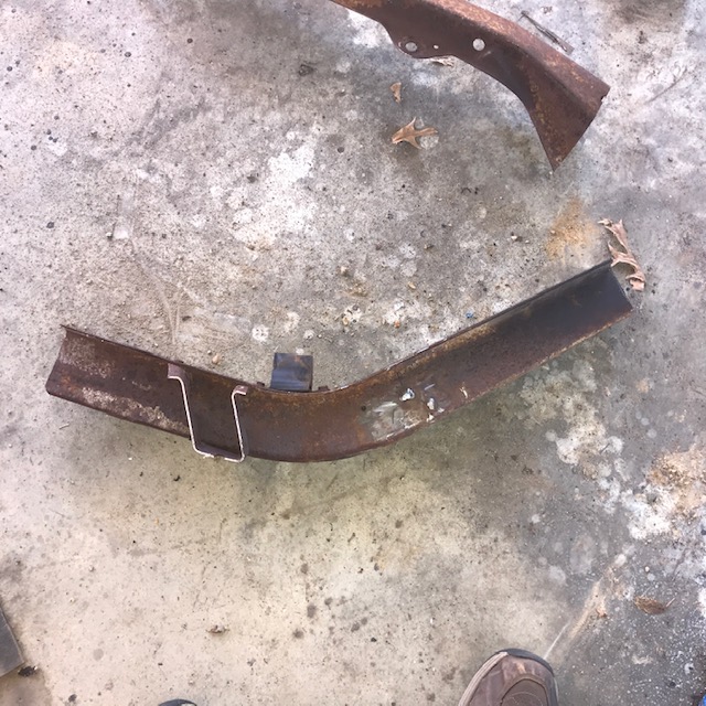

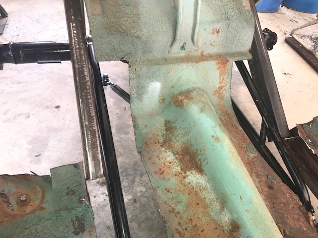

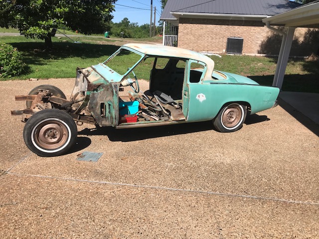

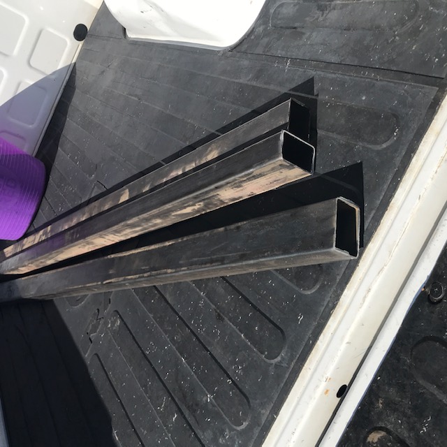

I honestly thought I had finished drag racing. I was wrong! It was a low swing in interest because of several factors and life events. With the WoodBaker project, I initially envisioned driving it around town and "touring" the back roads while driving too fast. As I began working on it, I realized that driving those back roads too fast would, sooner or later, get me in trouble with the law, neighbors, or both.
In addition, I began to visualize how it would look and perform on the track. First, I took measurements for rear tire fitment, pondered, measured, and then pondered more. Finally, this photo shows what will be required to fit the correct size rear tire.
Also, did you all realize that new Studebaker bulk rear frame sections can be bought at the local supply store? [see the last photo]

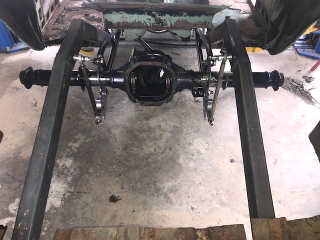

8.8 rear and long ladder bars
