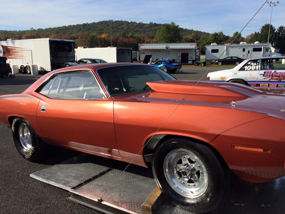

As some of you may know.. 2 years ago we debuted our new 2 car team with a 1972 Barracuda H/SA car.. We tried it for 2 years but recently decided at the New England Nationals, It was time to move on.. We thought we would love the stocker thing but we are true .90 racers and have roots in bracket racing.. So we decided to sell the car but wanted to stay with a 1970-1974 Barracuda..
My dads S/G car is a 1970 Cuda so I grew up with the great love of 1970 Barracudas.. well it just so happened that when we sold the stocker, a 1970 Barracuda came up for sale on racing junk.
We jumped on the deal and brought the car home after having it delivered to the Maple Grove Dutch Classic.

Here are the details on the car
1970 Barracuda
Original AAR car, not that that matters anymore..
All steel except Hood, Fenders and Bumpers
Car is a Back Half, Ladder Bar car with a Dana 60 rear with 4:56 gears and Moser Axles and spool.
Weighs a light 2,650lbs without driver
Car was converted to front steer rack with all the stock front end parts and control arms..even down to the stock disc brakes.
Has a 470 cubic inch stroker in it, based off a 400 block
440 Source Crank and Rods, With 440 source aluminum heads.
Crane 1.6 Gold Rockers
H-Beam Rods with Ross Flat Top pistons.
.590 Solid Roller Cam
M1 intake with BG carb as car was ran on E85
727 TF trans with 8" PTC converter and Tranz Act Brake
Car has a best of 10:10 at 130.. We plan to get into the 9:90s
A lot of stuff will be changed and new on this car so we didn't waste any time getting started
