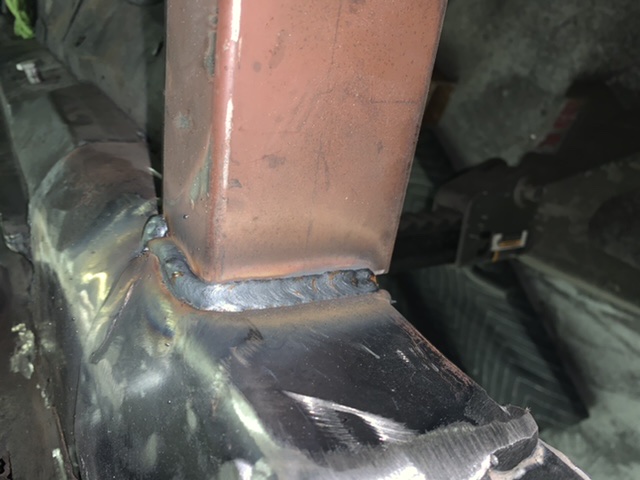

Default Re: 1969 Camaro SS/EA Build
First thing was to get the frame rails put in. We used a frame rail kit that was pre bent and welded together for a first gen Camaro, we just had to trim to fit. We added a cover piece where the crossbar connects to the rocker to add a “finished look”. Like I said I’m not a welder, but really enjoy it and pretty proud of some of the welds so far.

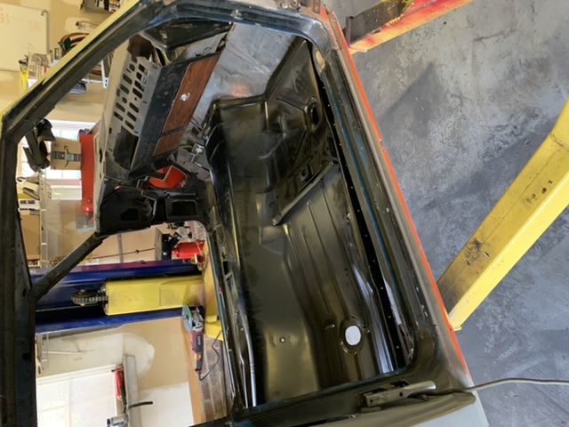

Once the frame rails were in we could move it over to the lift and do some more work on the body. The outer cowl boxes were all rusted and basically non existent so I had to replace those . The floor also was patched together from years and years of rust fixes so we decided to just replace the floor (which was a lot easier than I thought it would be)

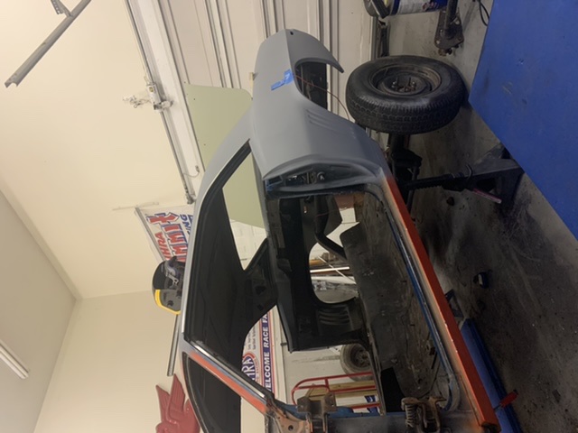

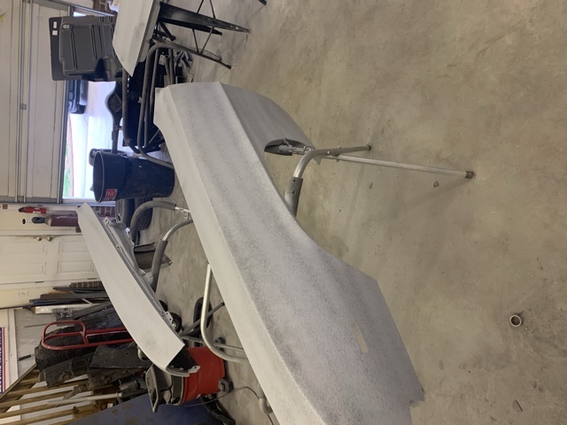

We got some of the roll cage in but quickly realized the tubing we ordered, the bends weren’t going to work so it caused a few week pause on the cage. I took that time to start on the body work on the front end panels. When I built my current SS car , it was originally my dads car from the 70’s and I decided to replace the front sheet metal with new, so I had original fenders and doors that were pretty rough laying around. Fitment on the new panels is terrible, so I took the down time on the car to massage the old sheet metal. I researched and learned a lot about different primers and blocking techniques. I body worked them, got them pretty smooth, primed them with high build stuff , blocked that back down and sprayed again with 5 coats of high build to hopefully block back down to be laser straight when all hung .

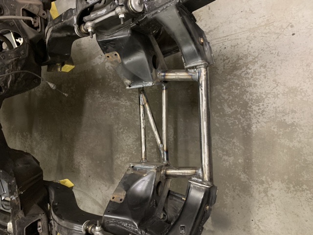

We will be running a bigger oil pan so I had to modify the cross member . We aren’t going to run a pan that has the steering going through it, so I added bracing between as a simple precaution, I realize it probably doesn’t need to be there.
