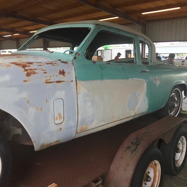

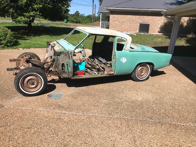

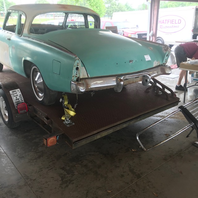

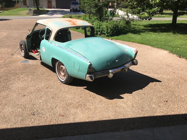

The StuFin core
ID:	64212   Click image for larger version
ID:	64213   Click image for larger version
ID:	64215   Click image for larger version

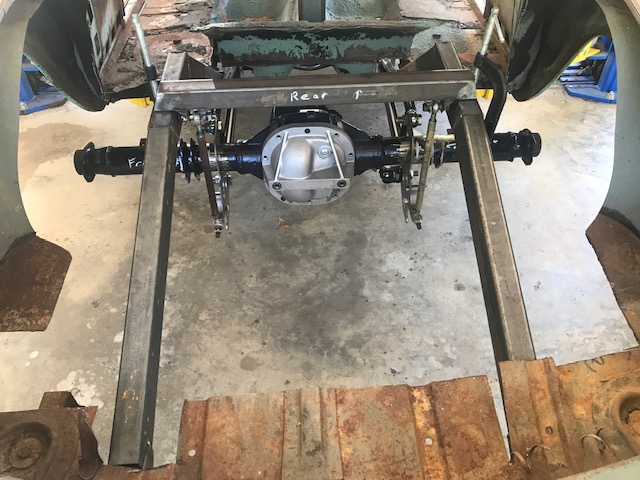

For the last week or so, I have been sneaking up on the ladder bar cross-member and rear shock cross-member placement. The fitment for both is tedious because the frame sides are not parallel in either area. I considered adding some plates that would make the fit up parallel, but after pondering, I decided it would be best to have the cross-members fit snuggly to the frame. So, I am about there, and since I have no timeline, all is well. Once it is all fitted and welded, and painted, I will post photos.
The rear frame and suspension work will finish in a few weeks, and we will turn to other areas.
Larry Woodfin 471W

The Woodebaker must be different.
Larry Woodfin 471W

I am satisfied with the rear section work.
Larry Woodfin 471W
