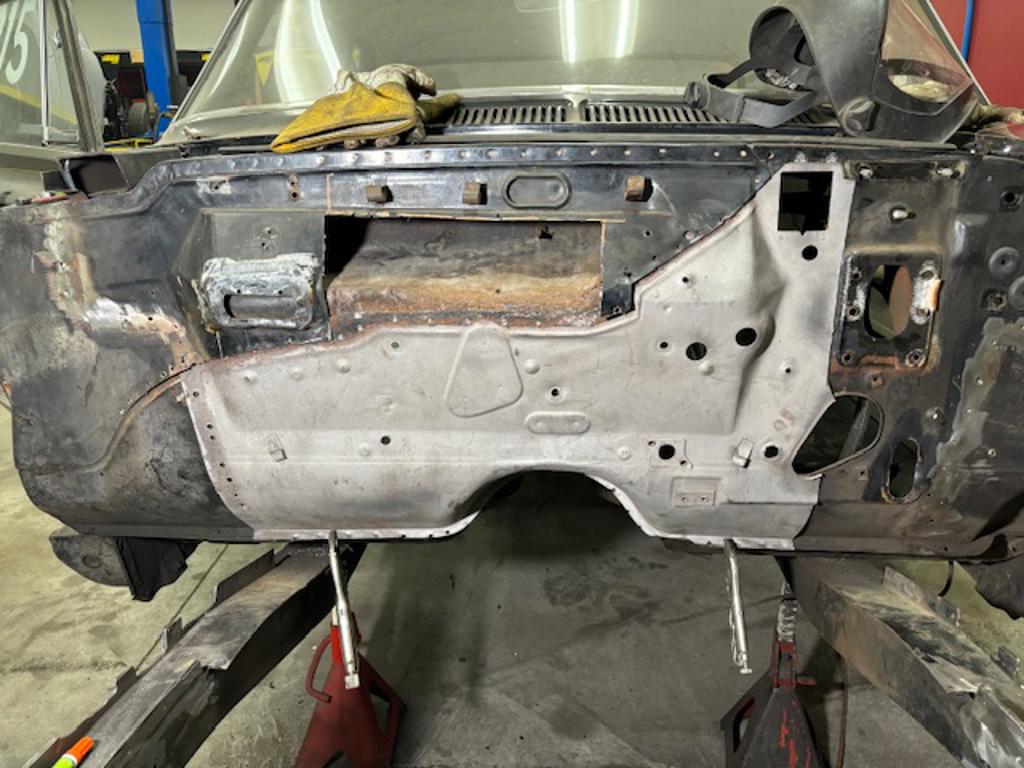

here's a few pics of the front inners and firewall replacement .the OE radiator support with the vin was straightened out and kept in place.
The inner fenders and firewall came from a junk donor car Alex had .
The firewall had been seriously "worked |" for clearance besides the damage fro a trans/converter explosion so it was seamed in at the fender wall attaching points.
