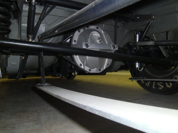

One of the fastest LT1 Camaros in the land runs this S&W anti-rollbar setup.
How is that upper cross bar fastened to the frame, or subframe I guess I should say?
http://www.swracecars.com/Files/pdf/40-613.pdf
