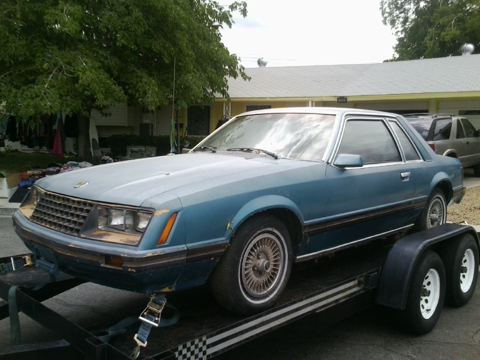

Busy day today. Pulled the motor, trans, exhaust, and fuel tank. The junk pile is growing!
