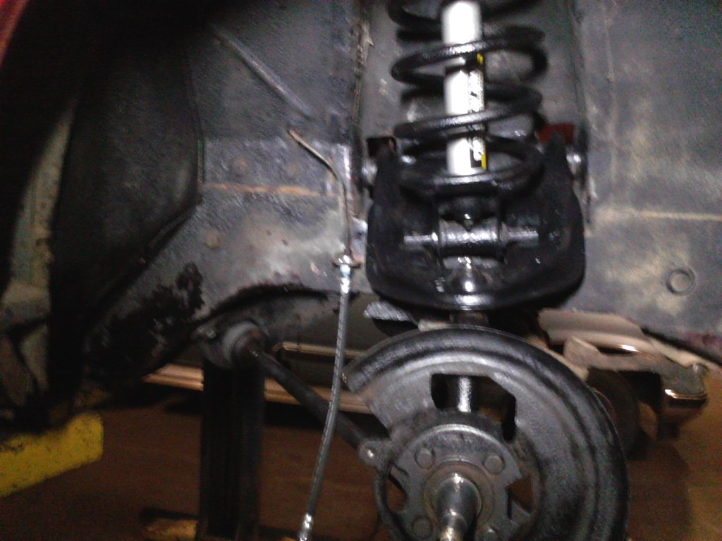

While we're on the subject of springs and such, I have one shot of a nearly completed right side suspension.

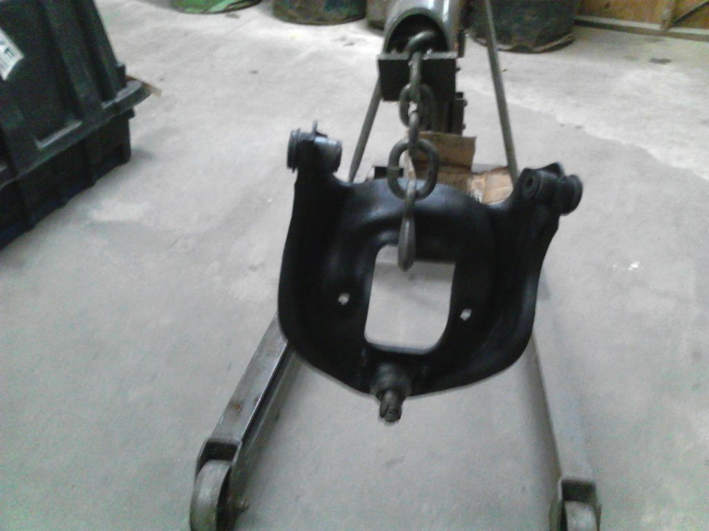

Newly rebuilt right side suspension installed less brake pieces. Amazing what some freshening up, wire wheel clean-up and some semi-gloss black paint can do. The engine cross member is in place now and the car will roll again.
Next time the auto shop bay is empty on a weekend, the left side gets the treatment.

Originally Posted by Pinballer View Post
I hope you're right about the springs Sean. The 100,000 miles of wear they have is a cause for concern to me, but right now I need them in there to hold the front end up!
Brian,
FWIW my current springs in my car are original 78 Mercury Zephyr 4 cyl springs from a previous car with over 100,000 miles that I had a 351 C in. Those same springs have been in my Mustang since 1998.
As long as your springs have not been heated I cannot image them being a problem.
There is nothing better than the sense of accomplishment on you building your own car, it may not be cheaper, but you will know every nut bolt and wire in the car.
Think about adding front tie downs into the front crossmember. It will make loading and unloading the car faster and more secure too!
Sean
