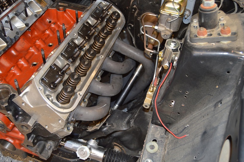

I’ve been working on the car for 3 months now. Lots of small things accomplished and I have acquired a bunch of parts.

Ordered a rebuilt manual rack from Rock Auto to replace the power rack (same as a Fox Mustang). I received it in December and left it in the box until I needed it. Opened the box in March and of course it’s the wrong one. Turns out they are not available from them any longer.They allowed me to return it. Ordered and new one from Summit that fits and it was only $15 more than a rebuilt.
Decided to stay with the 4 lug hubs and brakes up front. Disassembled the front brakes and ordered new pads, calipers and brake hoses from Rock Auto. The parts didn’t fit, turns out the spindles had been replaced with Turbo Coupe spindles. I had to return and order new parts 3 times before getting the correct ones.

Trying to get the Trick Flow 185 CNC heads approved for stock with a 2 HP increase.
In reality they probably would loose HP with no cam, carb or manifold to support them. Just using them for mock up.
