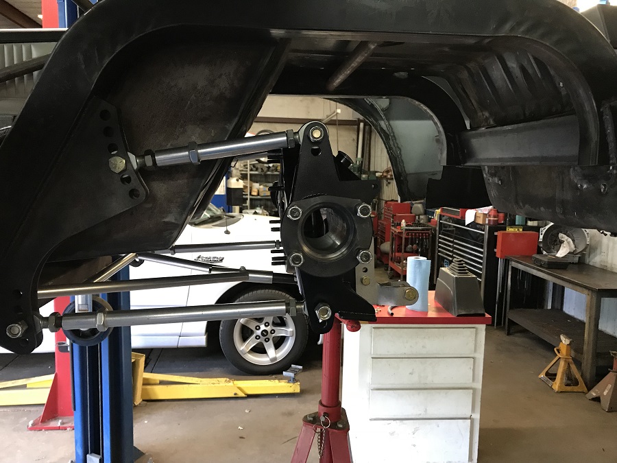

it begins! I will and an anti-roll bar kit

If it was me, I would lower the front of the upper bar by at least one hole. Kinda funky geometry the way it is now...

notice that no shocks are installed and that a jack stand is holding the housing in that position.
I will contact Quay and set the initial adjustments per their recommendation. Doing that is some time away. Lots of areas of attention to address before the final setup takes place.

Bottom bar 2 degrees down towards front of car. Notice in the pic provided the bottom bar is in the upper hole on rear. Both rear housing mounts should be in outer holes. When lower bar moved to outer housing hole, the rear will need to go up into chassis. This will increase downward angle of top bar. I believe the top bar in pic is in preferred initial location. Shock settings should provide minimal chassis separation or squat.
