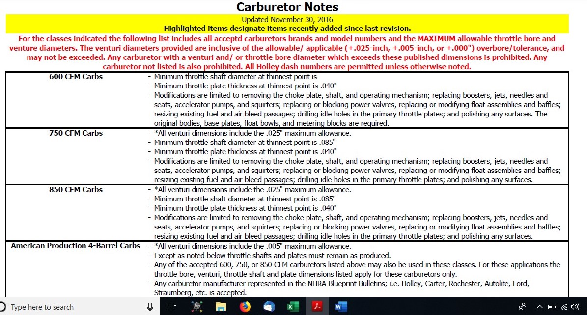

I don't see anything in the rule book on this, but in the accepted products document there's a section called carb notes, and it says it's ok. Although the way the documents reads, it's not super clear what it applies to.

Carb notes apply to carburetors used in Comp and SS/Modified, not regular Super Stock or Stock.

page 62 does mention Stock, SS, etc. But the context is replacement carbs, so probably doesn't include alternate carbs..........

So I get where the rule book does not allow removing the choke. The reason I started this thread is because it looks to me if you are allowed a "replacement" carb, i.e. edelbrock, or quickfuel, which seems to be legal in stock, it spells out in the carb notes what mods you can do, and that includes removing the choke. That doesn't make sense to me, but that is what I see. Maybe I'm reading it wrong.
