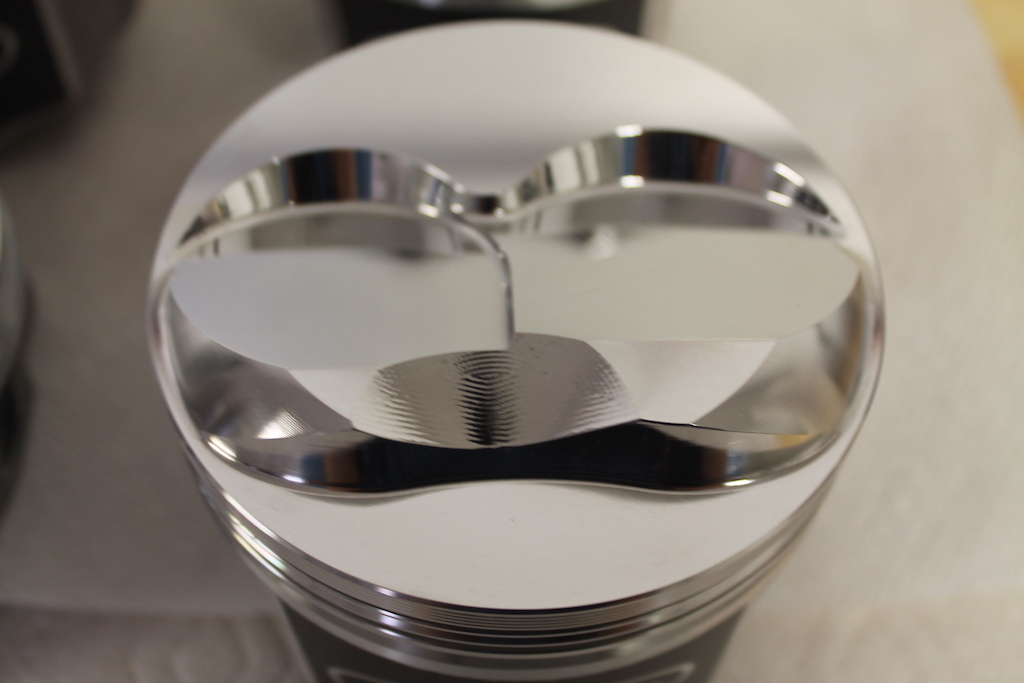

I got the pistons last week, Icon .040 -12.7 CC dome, they came in at 712 grams with pin after some work.

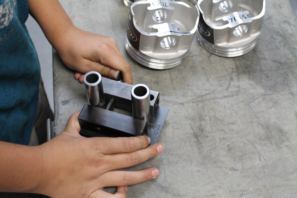

Old 09-08-2019, 09:47 AM   #57
MIKE JONES 302
Join Date: Aug 2018
Location: Colorado Springs Colorado
Posts: 28
Liked 85 Times in 15 Posts
Default Re: 302 Chevrolet Engine Build

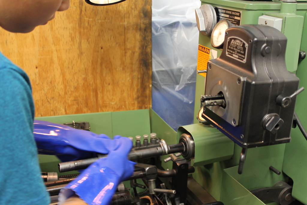

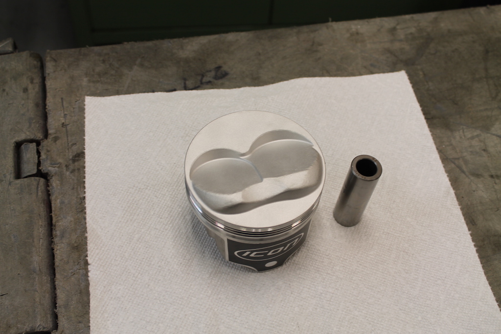

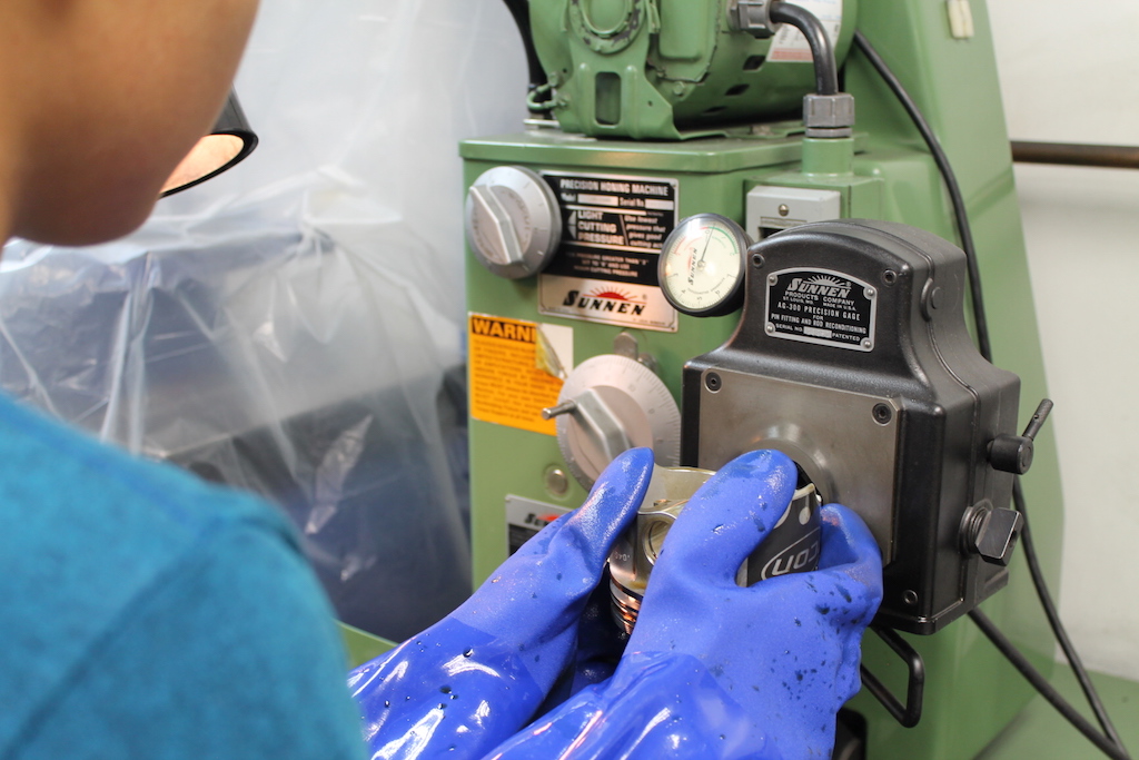

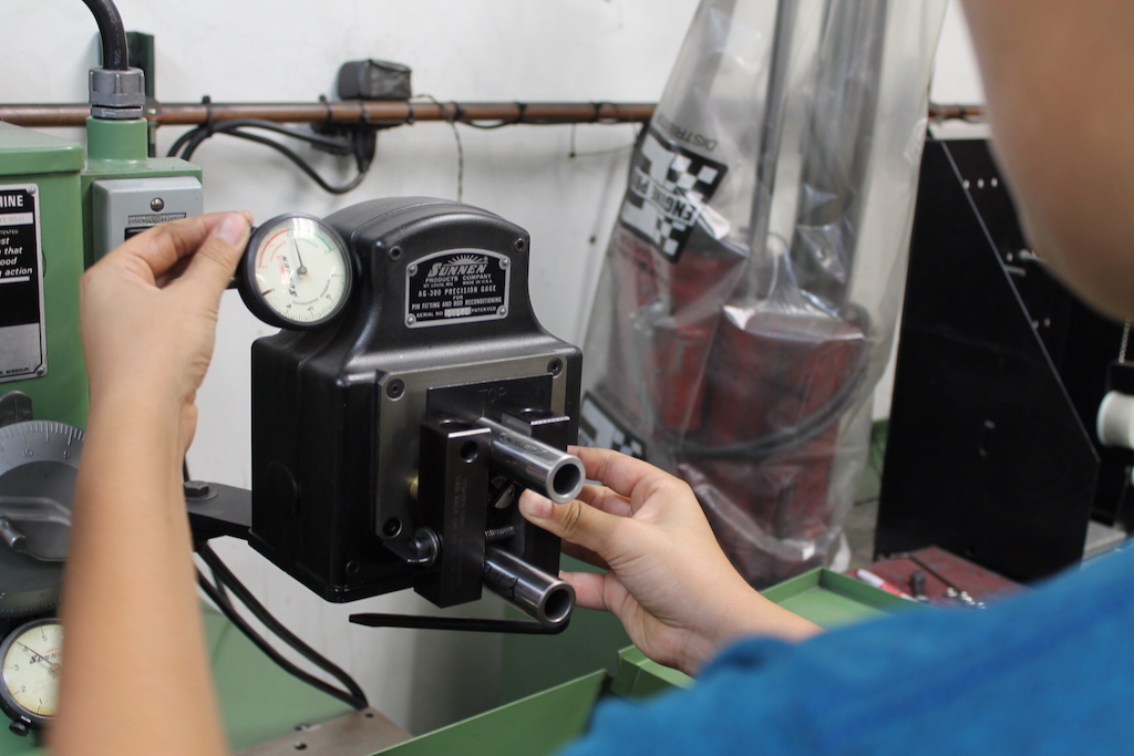

The finished piston. Some more pictures of sizing the wrist pins, size was set at .0008. I have to drill and tap the crank snout next and have the crank flange cut, then I can balance the assembly. My dad will hone the block then I can assemble the short block.
