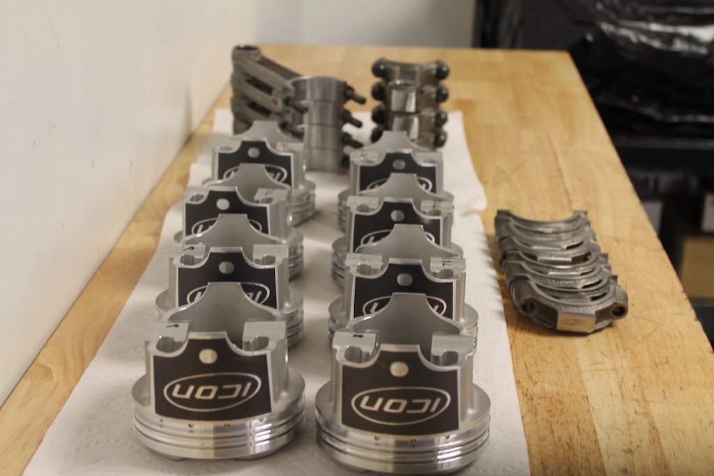

I got some parts for Christmas, so I plan on getting the short block together next week. I mounted my pistons up, and drilled the crank snout for the balancer bolt, a friend of mine faced the crankshaft flange for me. I balanced the assembly today, it needed 4 grams on the front and 9 grams on the rear, both on the crank pin side. My Dad will hone the block for me and I can start assembly.

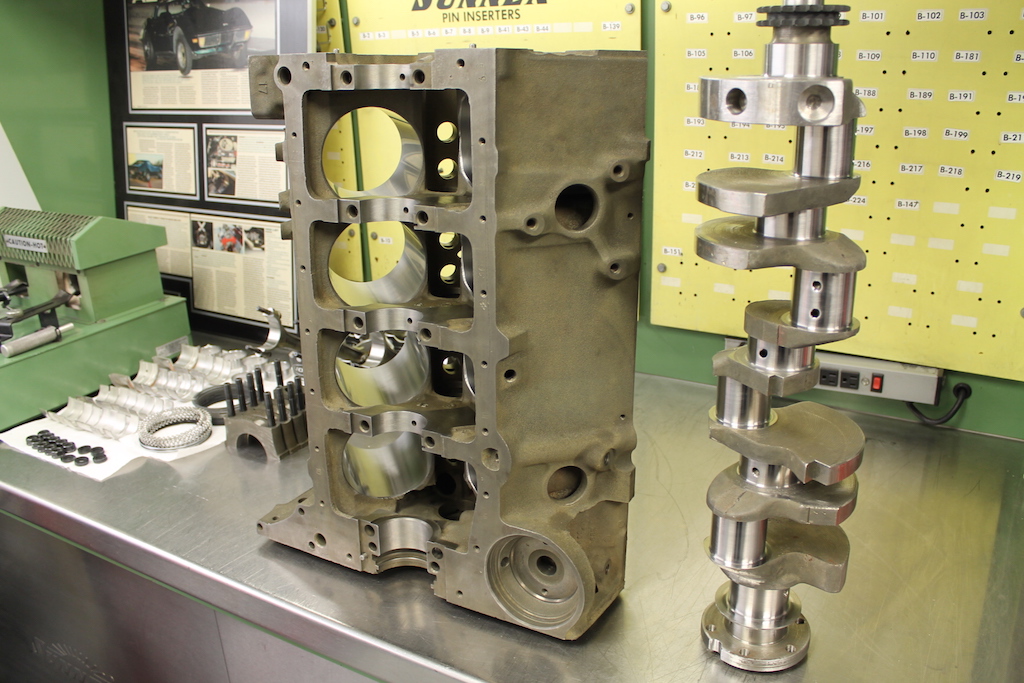

Block is honed and final cleaned, should have a finished short block tomorrow.
