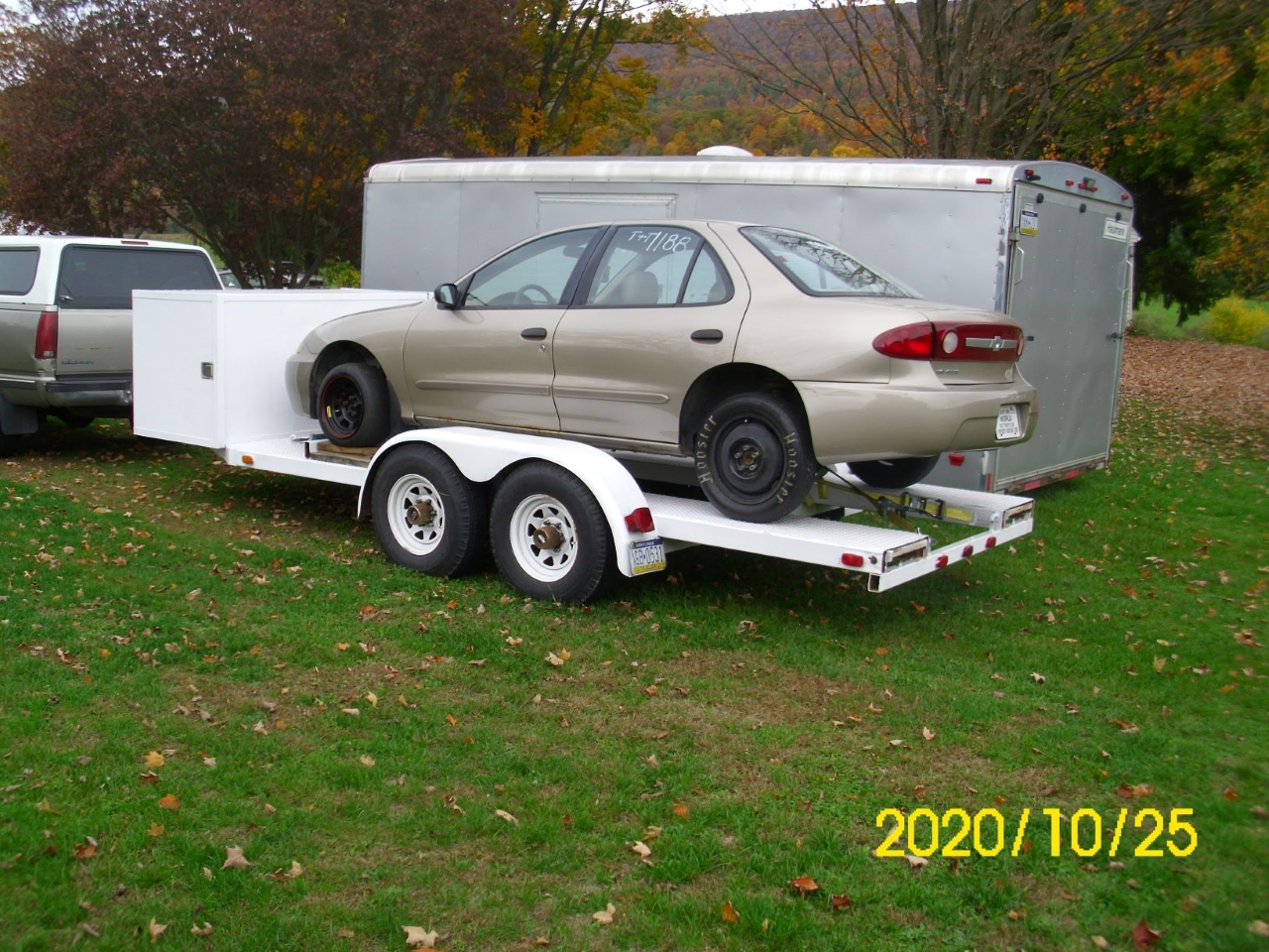

I got an update from Mr. Billy the other day with news that the header is done. He was unable to upload the pictures, so he sent them to me to see if I could get them uploaded, so here they are. Couple miscellaneous pictures of the car in here as well.

Old 02-16-2021, 10:11 PM   #176
Posts: 7,822
Likes: 2,916
Default Re: Not for Nuthin' But Close!
That's not Billy's trailer, is it? ;-)
Someone vandalized it and took off the patina when he wasn’t looking....
