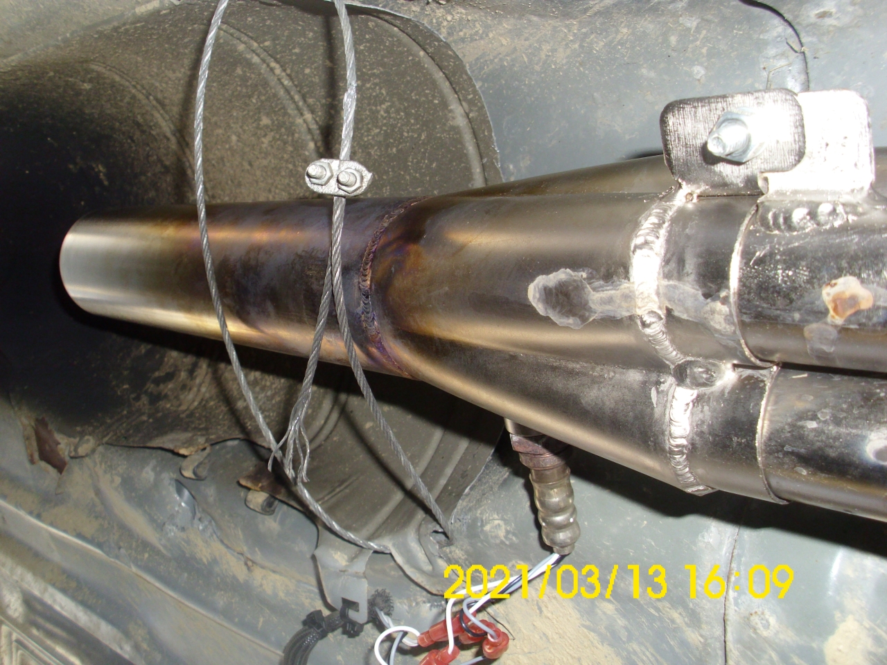

Here are some pictures Billy sent me to upload on here.
Name:	Me Tuning.JPG
ID:	57067   Click image for larger version
Name:	Cavalier Collector.JPG

Well, in the openness of "fair-and-honest" reporting I guess that I should mention our last outing at Cecil. I don't really WANT to as it wasn't a banner day but I guess that it could have been worse. I at least learned some stuff.
The brakes worked out great! Doug could hold the car at 3 grand if he wanted to.
I built 2 different collectors for the car. The original one was 2 3/4" dia and about 15" long. I built one 2 1/4" and 15" and a second 2" and 24" planning on cutting it down.
I don't have my timeslips and notes with me but we made 7 runs all between a 15.25 and 15.28. Not too bad for changing things between runs. It wasn't a very good day, low baro., high humidity and head wind but at least the sun was shining. As I changed the collectors, we started to see a pattern develop. It went it's best MPH (by 1 full MPH!) with the 2" collector cut to about 10" long but it went it's best ET (15.25) with the original collector.
This past week, I was able to find some specs on the original cams and although they're both very small, the exhaust cam is really small. I'm starting to think that the restriction that is cast into the original exhaust manifold is there for a reason (duh, gee do ya think?). At any rate, Comp DOES make a "streetable" cam set that is a bunch bigger than the original ones and is under my .430 lift limit. I guess that I've got to buy some cams.
Billy Nees 1188 STK, SS
