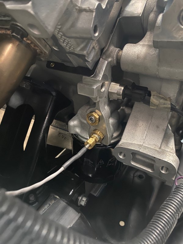

Above the oil filter on the block there are two 3/8 NPT plugged holes. Bottom one goes to the filter and crank driven oil pump and the top one is the passage the the oiling system. I use a three gallon viton seal bug spray to pressurize the system the system. The mess occurres when the hose is disconnected and the plug is installed with my left hand.

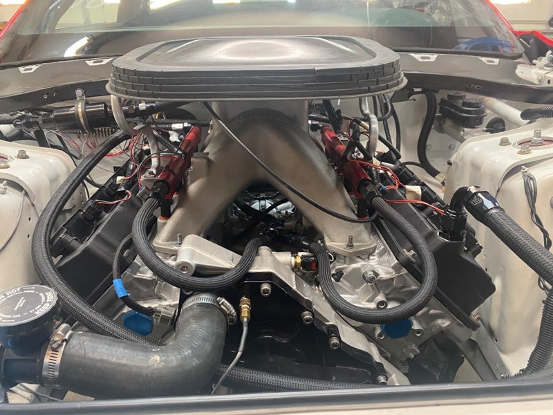

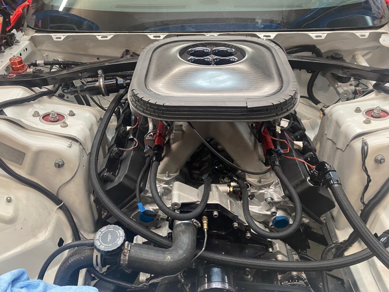

I spent a better part of a day looking for some body parts that I put up to keep dust off of them. I tore the car apart after Indy and just now putting it back together. Sometimes I forget where I put stuff, just another stupid old man trick. I will not get much done this weekend 'cause it March Madness! Its the best of college sports on TV.

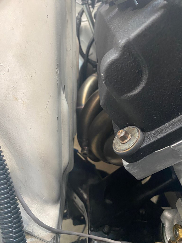

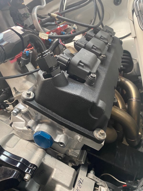

I got a lot done today. If everything goes well we should be smelling smoke latter this week. As y'all can see I till have a lot of cleanup to do on getting the wires looking better. It's a real pain to get the valve cover off on the passenger's side just to check valve lash. Headers have to go on in an assigned order. Believe it or not I can get 10 O2's on the car and only have to install one in the pipe before installing the pipe on engine.
I took a picture of the oil filer base with the two plugs that make a mess when I fumble them. Me and the air inlet almost look eye to eye
