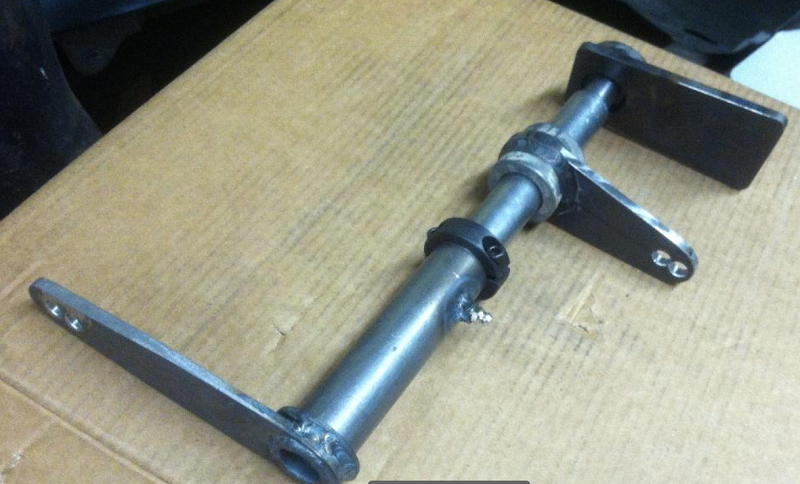

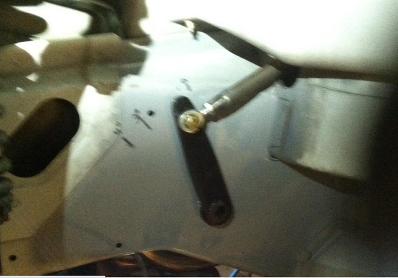

I did get some help from you guys on the clutch linkage.

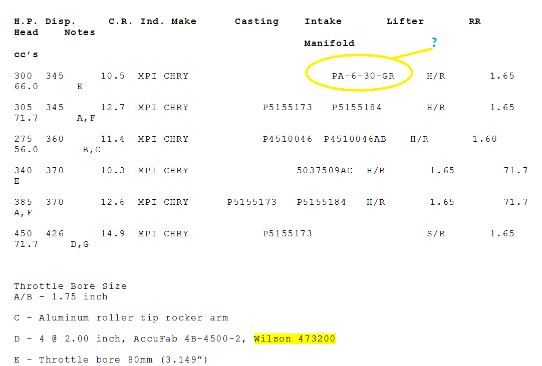

If possible can someone help telling me what this intake number is. amazingly somehow a record was set with this combo when there wasn't a piston approved. What intake is this. I have the original one on mine #68189105.
Paul
