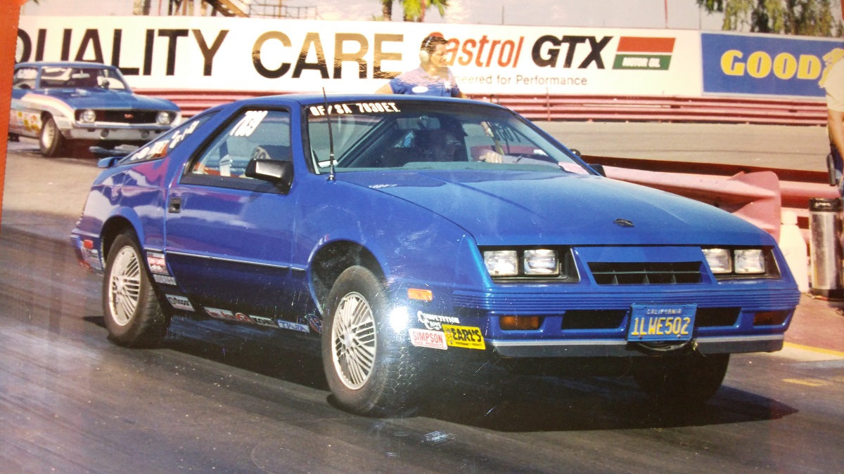

Just testing my resized pics so I can continue.
Through the years...
ID:	68129 1993 Day of Purchase, no...we bought the whole car, but the only pic I could find from the beginning.
ID:	68130 Spring 1995 GatorNats, FL

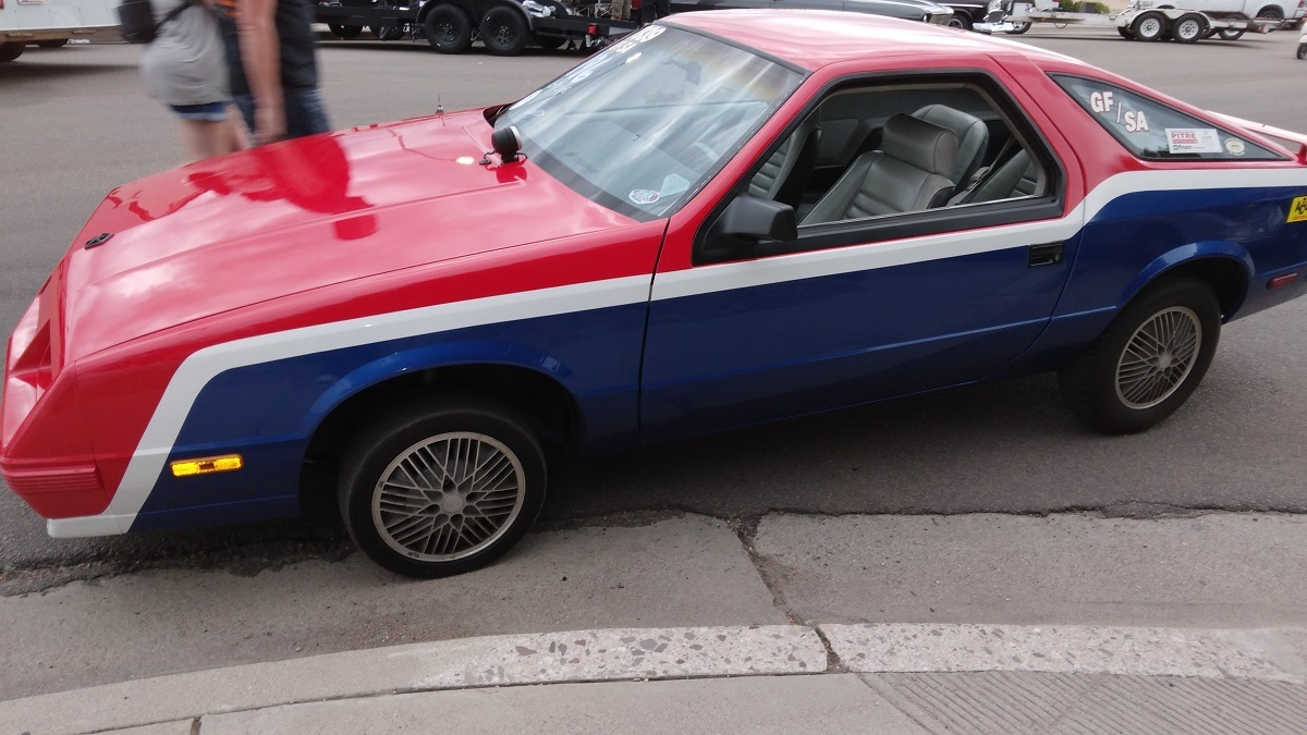

ID:	68131 This last May 20th, 2023 (Shakedown ring seating Pass 2-1/8th Mile Kingman, AZ Legal Street Drags on Rt. 66 on the Slicks) (An annual full track setup right on Andy Devine 3 miles from home, and a timely finish of a 15 month project. Short Block was in the machine shop a full yr. and 3 weeks.
ID:	68132 (Now ready to run first quarter mile passes this go around, as soon as NHRA hopefully re-assigns the same numbers...fingers crossed, paperwork and fees are in now). Yeah the G's went away yesterday, now EF/S is on it. Looking to first quarter mile T-N-T Vegas on the 8th of Sept. (Sportsman Brackets same weekend? Maybe)
I think I have the aspect ratio on resized pics correct if they post so I can get back to the build and changes over time. We shall see.
