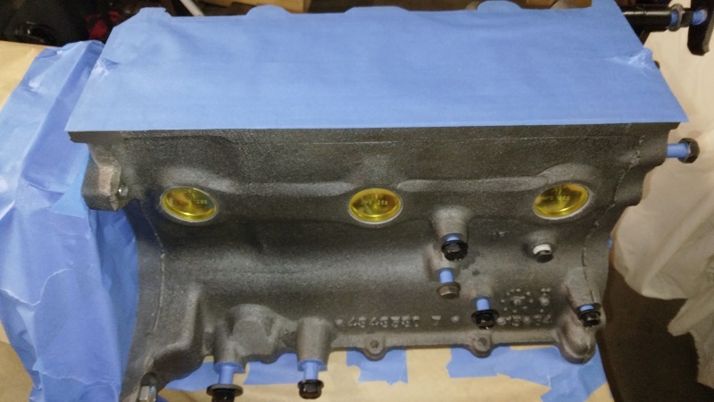

Though the car was painted a couple of times the engine bay was never empty until this 1st rebuild, so it was cleaned & done.

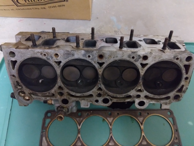

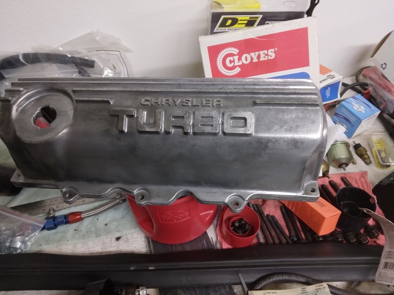

Engine coming out after roughing out the elect. water pump and a few other items like getting rid of that nasty stamped steel ugly valve cover.
It looked like 93K miles and 25 years of sitting.
