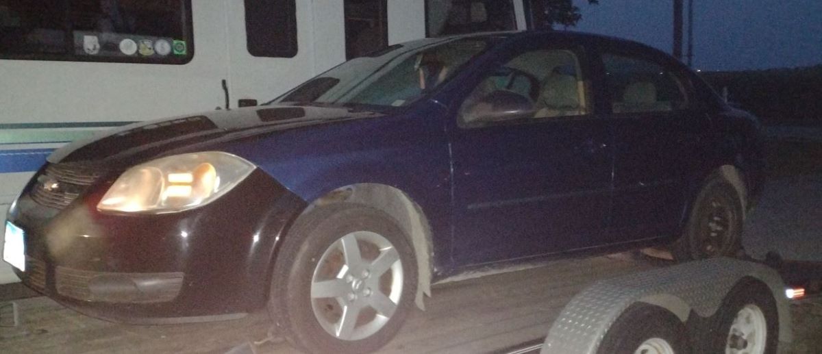

July 3rd, 2023 the car is loaded on a trailer and headed to Indiana to start its stock eliminator journey. Here is the picture from that evening and the beginning of the build I'm calling "SLOBALT"

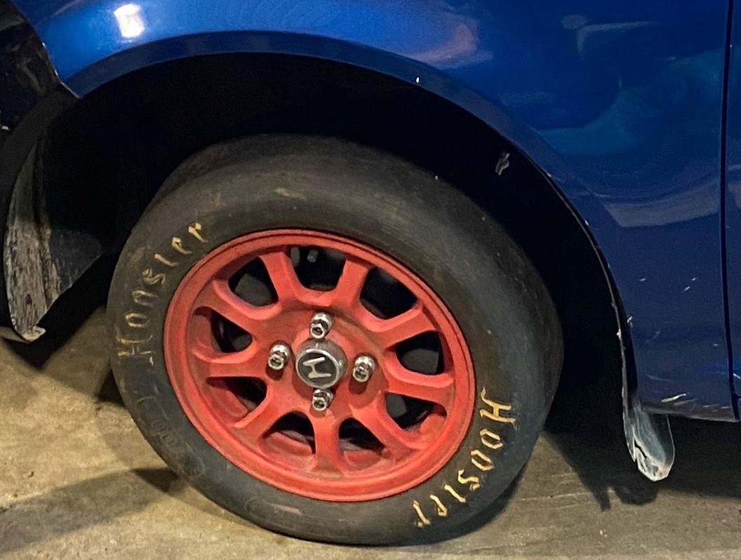

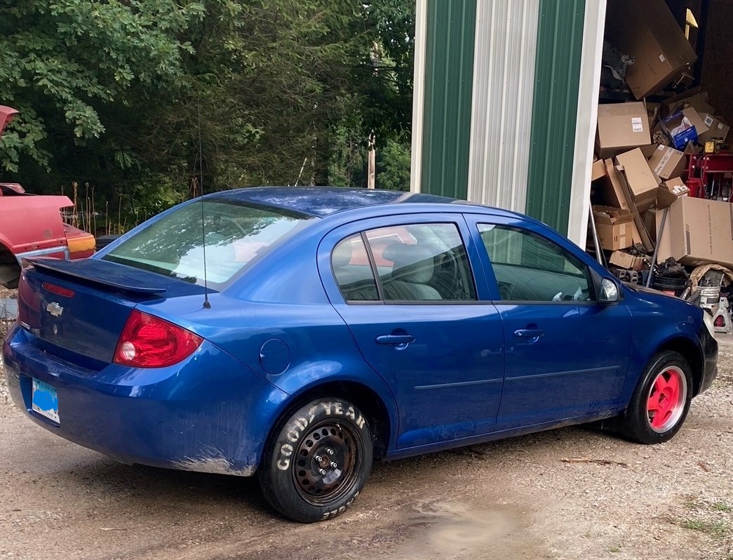

It is now July 10th and we are filling out our first tech card for the Cobalt. Below are a couple pictures of the visible changes to the car for testing and then for the first race. So far, we've got calipers, rotors, pads, trans fluid, header, and a couple of oil changes for testing totaling just under $400 invested in the car.
ID:	68852   Click image for larger version

out of curiosity, what brake setup did you move too?
David Lee is offline   Reply With Quote
Old 10-18-2023, 11:51 AM   #8
Ellis V Buth
Join Date: Sep 2015
Posts: 104
Likes: 58
Liked 420 Times in 73 Posts
Default Re: Slobalt
It required a bit of fabrication work, but we were able to make the brake setup from a 1992 Honda Del Sol work.
The idea to try them came from the fact that one of the sets of rims we have actually came from a Del Sol so we knew they would clear the calipers and rotors if we could make them work.
Ellis V Buth is offline   Reply With Quote

i did notice the wheels were from a honda. was the fab work the bracket to hold the calipers?

Yes, that was the fab work. Expected for a build like this and I'm certain it won't be the last fab work we have to do!
