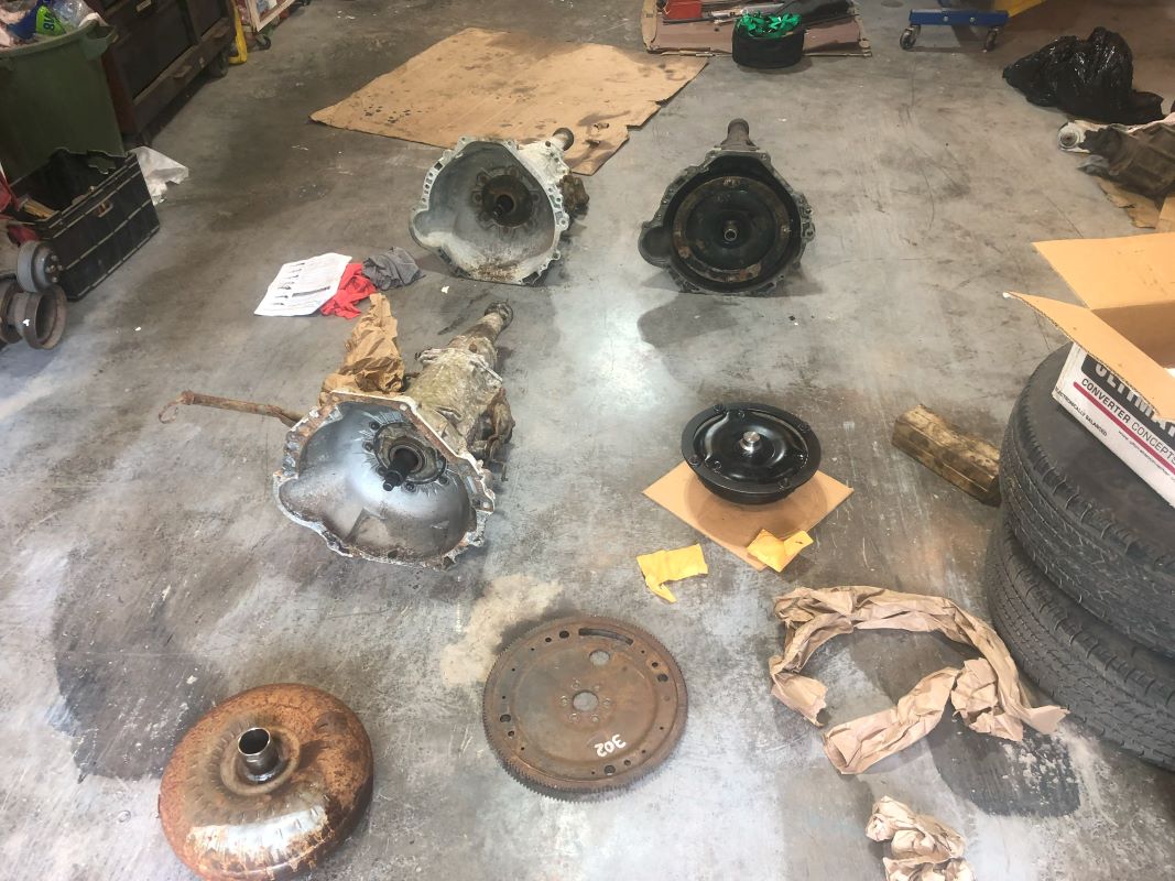

Got the tranny from out back, it's a case fill...with a 164 tooth bellhousing! Same as the pan fill is a 164 tooth flex plate.
I need a 157 tooth flex plate and bell housing which as far as I know only comes with case fill car transmissions.
Went up the road to a ford buddy and he has a c4 out of a 73 mustang/302 that he personally can verify it's original...it's a pan fill truck transmission with a small 157 tooth flex plate and smaller bellhousing!!
Holy CRAP!!! Nothing Ford does is the same from one minute to the next!
So I bought the transmission from him, now I have to go through it and install the reverse valve body, all I need now is the 157t flex plate. The one that came on the 302 we pulled this tranny from?? The bolts are rusted and rounded off holding the converter to the flex plate. So if I can't find another one from another local ford guy, I'll have to fight with that. The other option is order a new sfi spec flex plate..which I might do as well.
Nothing money won;t fix huh?

Just remember, as a rule, a one piece rear seal is the 50 oz. imbalance, and the 2 piece seal is 28 oz.
Flexplates can be had in either configuration.

Thanks Phil, Yes i knew that as well. Why make it easy, right?lol!
157t 28oz
157t 50oz
164t 28oz
164 50oz
Divide all that by
1) pan fill
2) case fill
Chev guys have it so easy, lol!!
