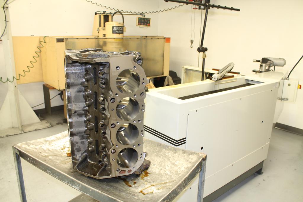

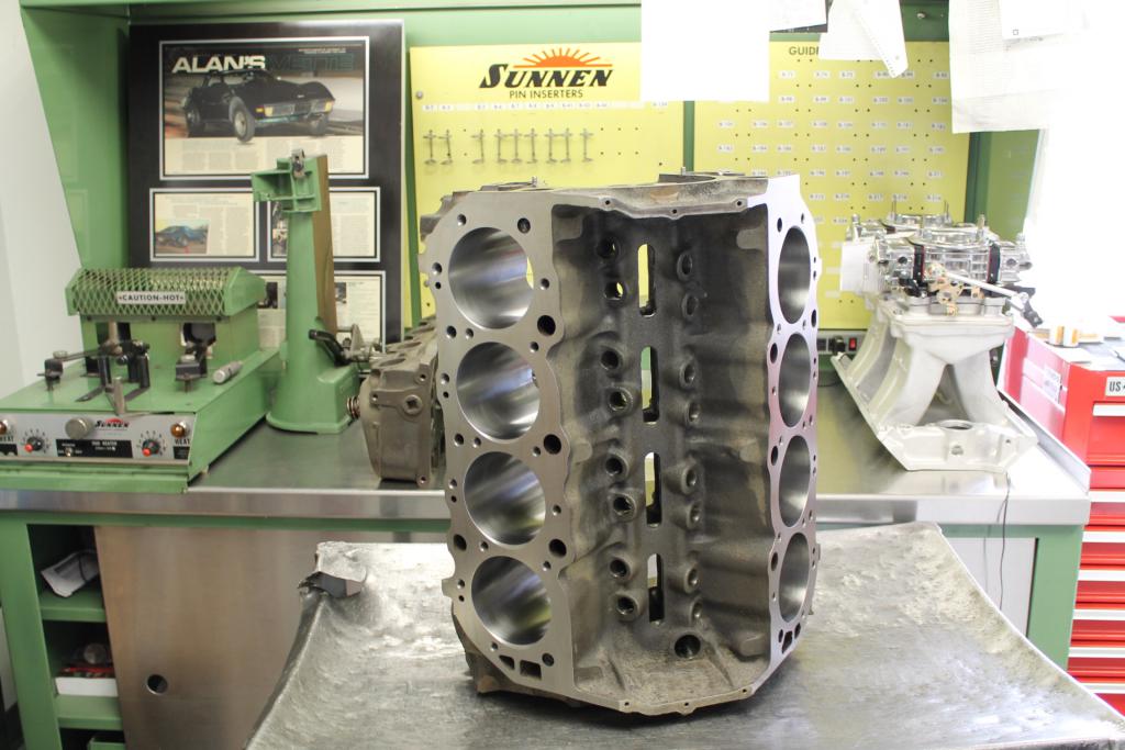

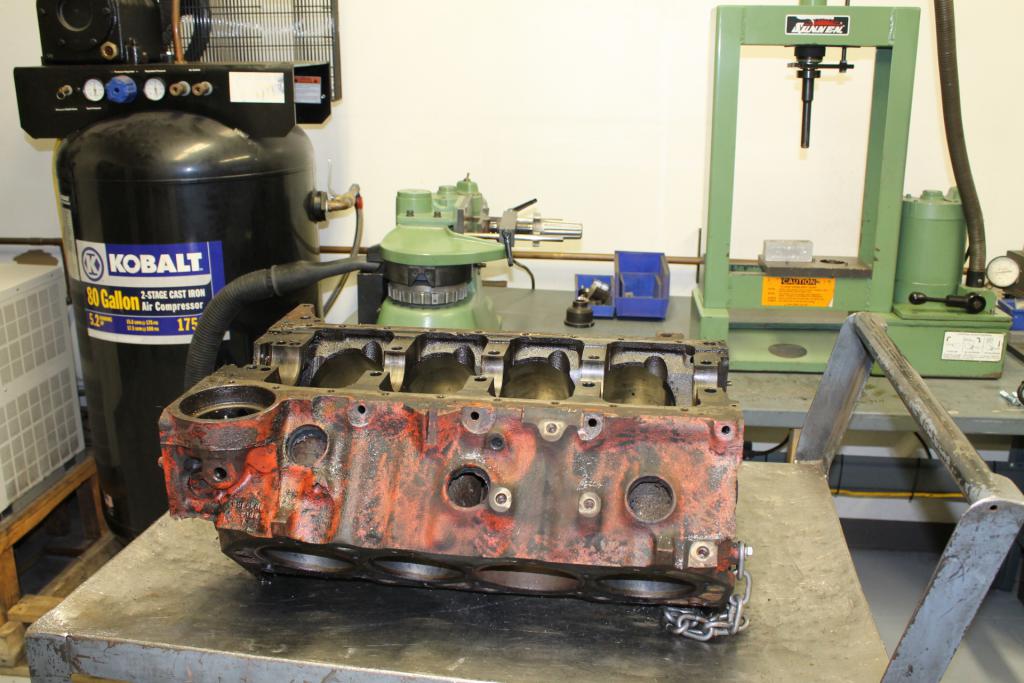

I put together a 4.310 x 4.00 BBC 467 Cu In, 10.3 compression, 781 oval port heads, 1.88/2.190 valves, Performer RPM air gap intake, 4150 carb with a 1 inch open spacer. Hyd roller cam 238/248/.578/.608/110, 1.7 rocker ratio. My goal is a 9 sec pass in my Chevelle. Here's some pictures of the build.

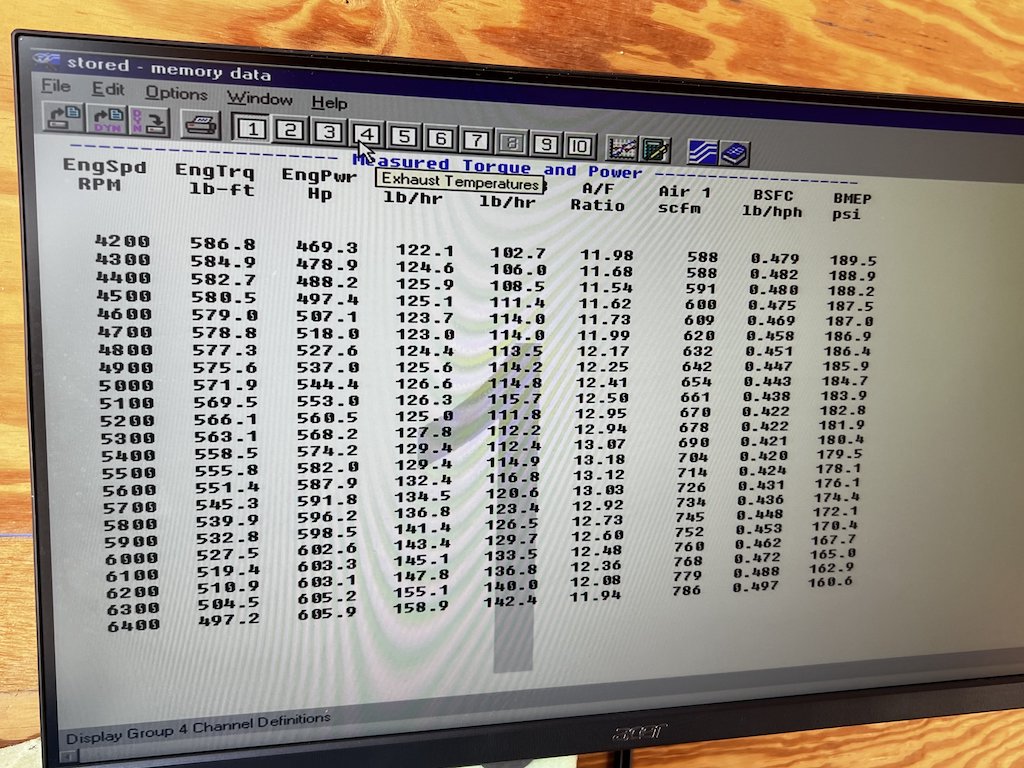

This combination produced this power @ 900 feet elevation, 29.27 barometer, 84 degrees, 30% humidity, 2500 DA.

Did you run the engine to a higher rpm to see when it falls off ?
Excellent question, no I didn't but we both know it going to have to go 7000 RPM at the line, and I've run that valve train that high before in a 496 before. BTW I'am a BIG fan of the work you do with your Camaro! I'am thinking you've noticed my dyno data other have not. Here's a simulation of a 496 with the same cam and valve train.

That's what I was thinking, climbing slowly so only another hp or two at 6500, so, 606hp, maybe holding to 6700 but I don't see any jumps in power above 6500rpm.
