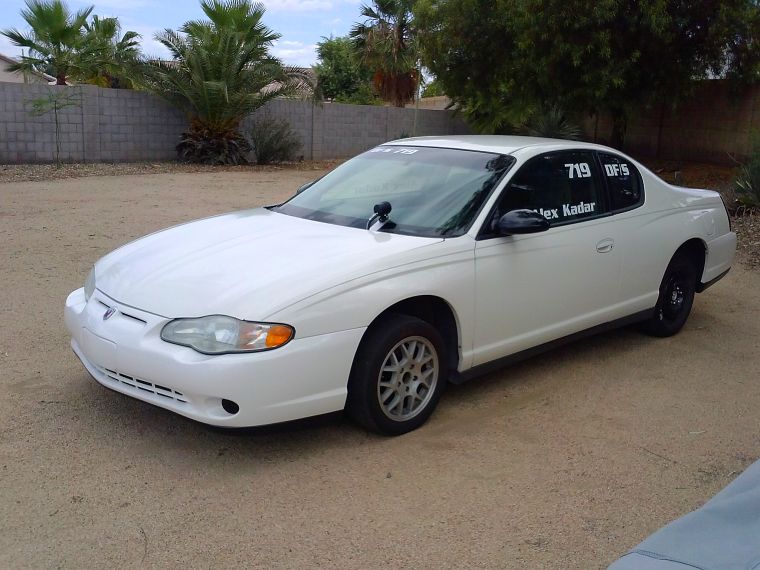

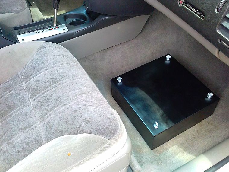

Update here:
We got all the permanent weight for DF/S mounted up front and added a small weight box where we could easily fine tune the scale weight. Have to say , it didn't help much with the traction though. We're hoping it will be somewhat better at a national event prepared track, in the daytime
We haven't really done anything with the suspension yet.
I'm going to have to research the availability of an adjustable front strut or at least a stiffer one. Then maybe fool with the camber and toe in.
Still need to do something about the steering rack. We need to replace it with a manual one or maybe one tooth less on the pinion?
Anyway..Last night at Wild Horse:
90 to 100 degrees
4000 to 4600 da
28.5 baro
All runs between 1.09 and 1.14 under NHRA index for sea level tracks.

Update here:
90 to 100 degrees
4000 to 4600 da
28.5 baro
Mark, BMR suspensions has suspension pieces for your car. Also, there is a company that sells a traction bar for controlling the front A-arms during acceleration and there are also aftermarket mount for the engine and transmission that replaces the gel filled OEM mounts. After looking at the BMR pieces, you might be able to replicate them.
http://zzperformance.com/3800/suspen...ion-mount.html
http://zzperformance.com/3800/suspen...dog-bones.html
http://zzperformance.com/3800/suspen...ral-links.html
http://intense-racing.com/Merchant2/...y_Code=3800_BS
http://www.bmrsuspension.com/?page=p...3&maincatid=53
You can use the KYB AGR adjustable front struts.
http://www.ebay.com/itm/KYB-734058-F...618897&vxp=mtr

Thanks, Joe
I think we could use the struts.
The rest has already been addressed or lists only the 3800 (Buick) engine.
I'm thinking we need to change the top of strut swivel to something of a spherical bushing nature. That in itself ought to help with the hard steering problem.
Do you think we could find something close, or time to fab something there too?
You know anything about the rack/pinion tooth count deal?
