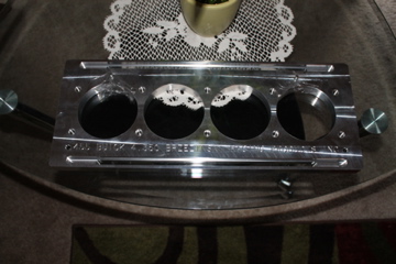

Some very important tooling showed up today!
HP HUNTER is offline   Reply With Quote
