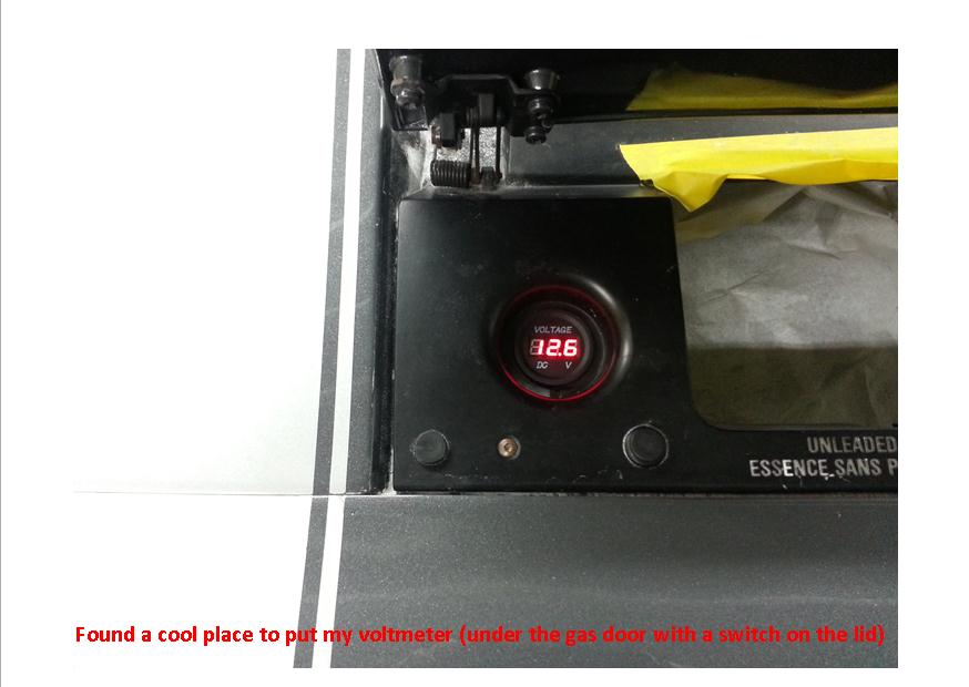

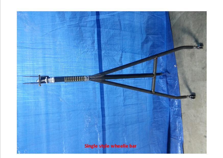

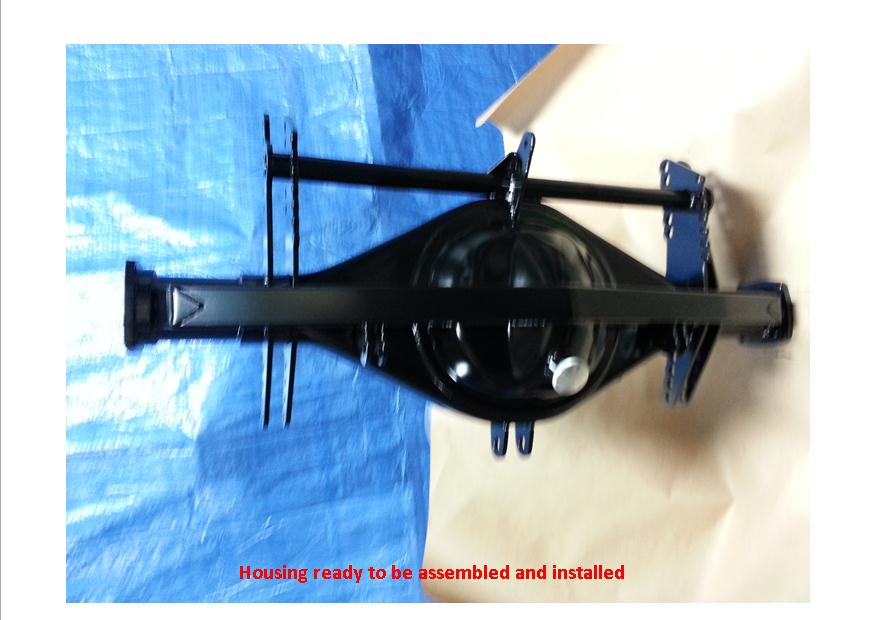

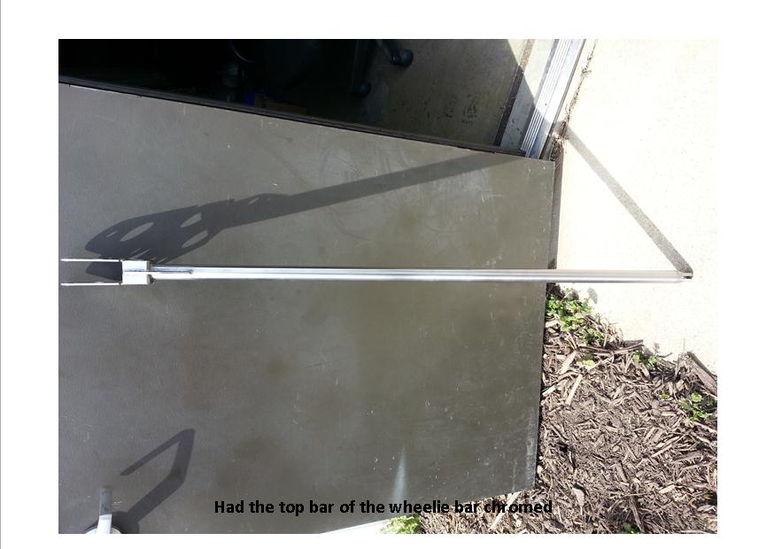

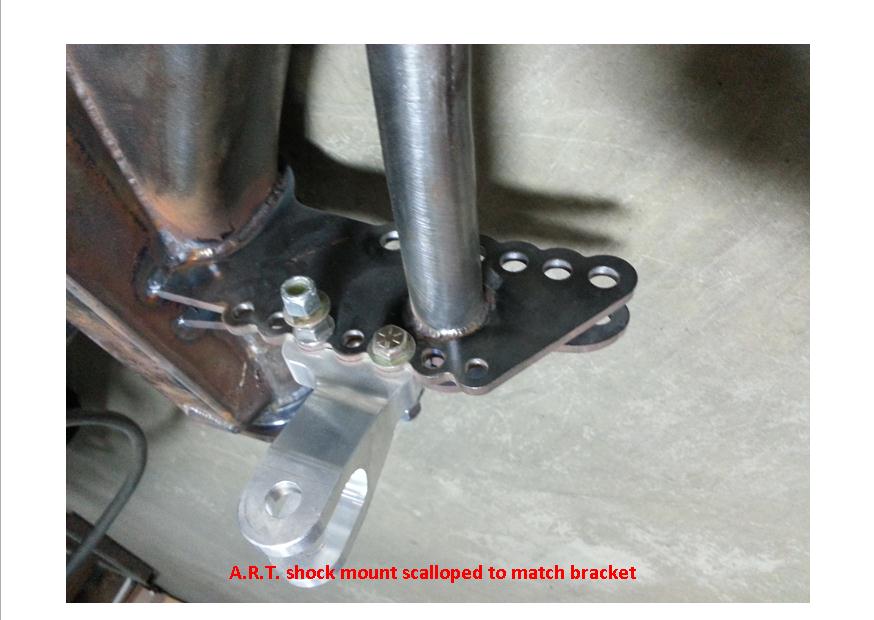

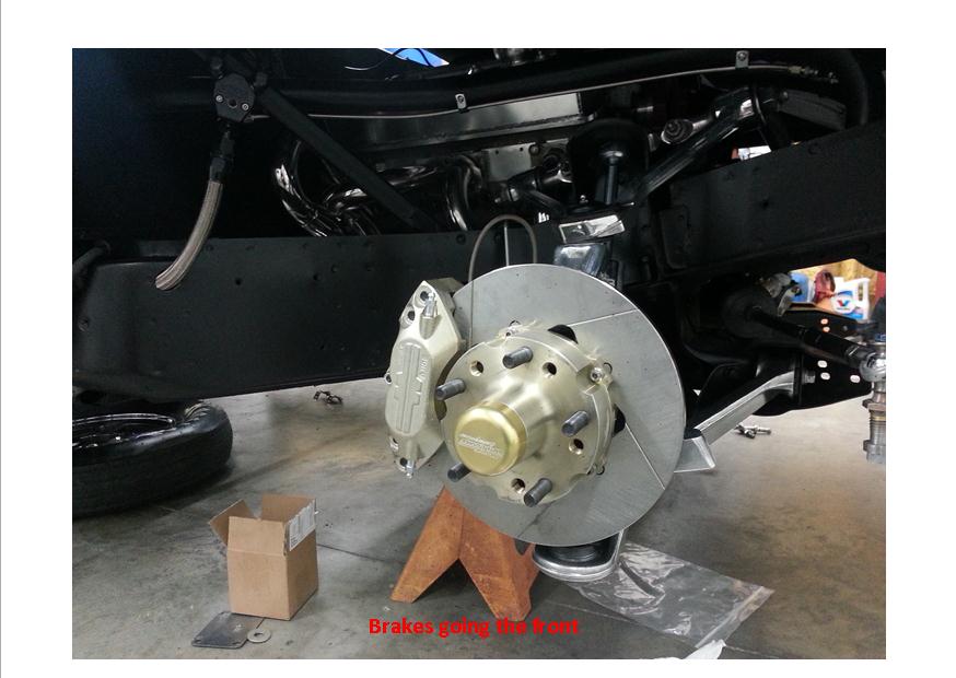

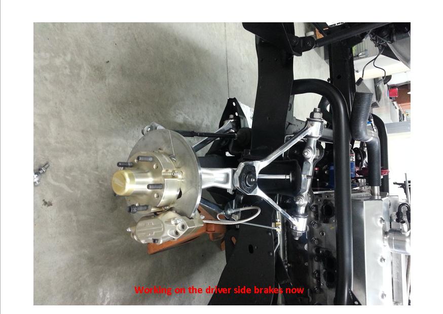

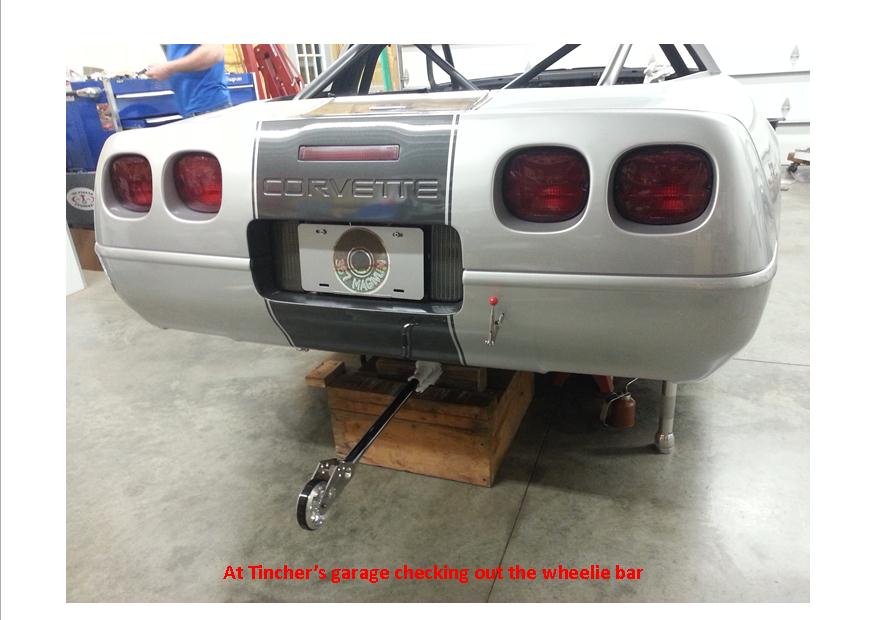

Top bar of wheelie bar assembly (yes it's a single)

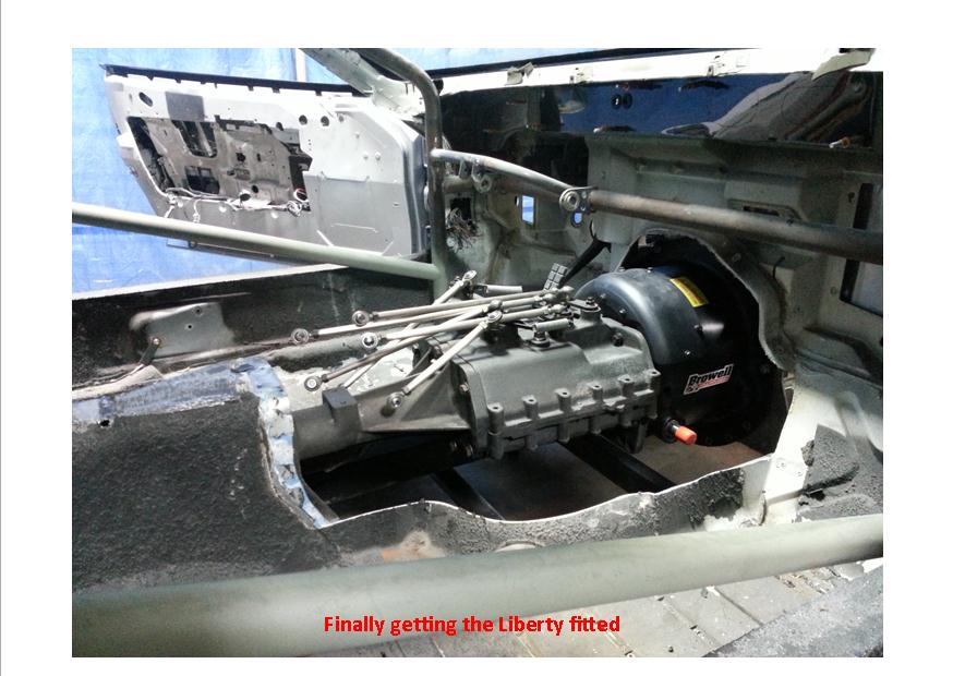

Transmission in place along with Browell housing

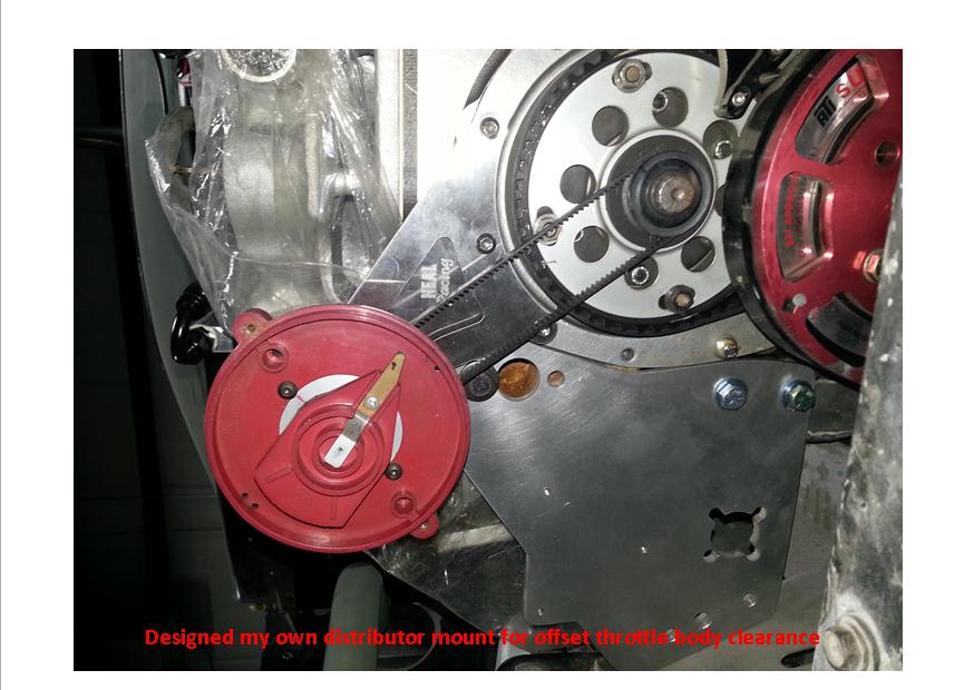

Developed my own offset distributor mount (can make you one!)
jesel or msd styles

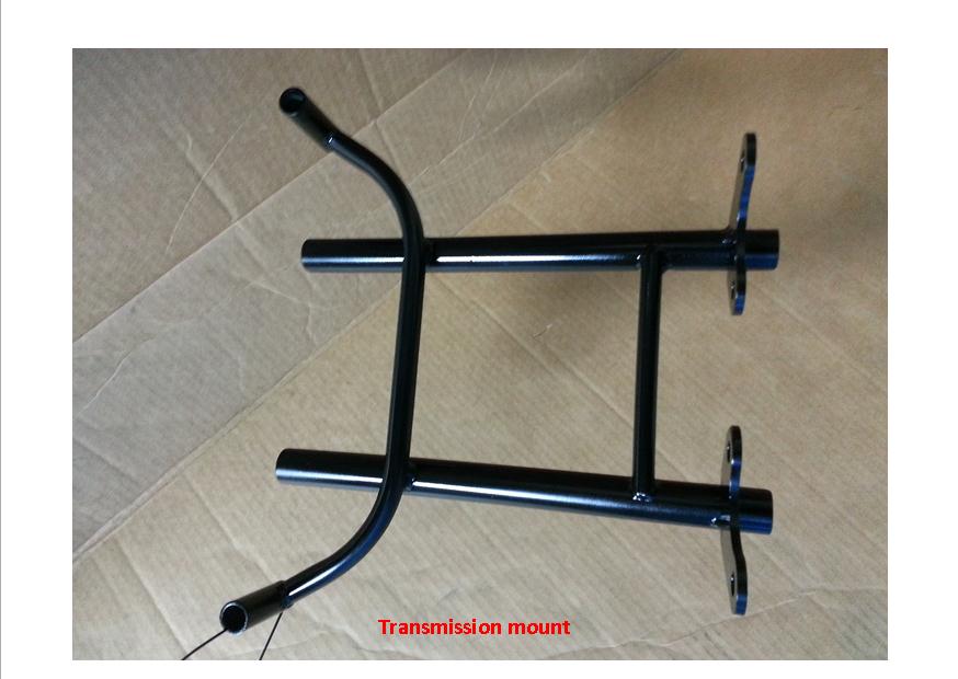

next is the transmission mount
the modified ART shock mount
rear end housing painted up
driveshaft loop
and under shot of tubs

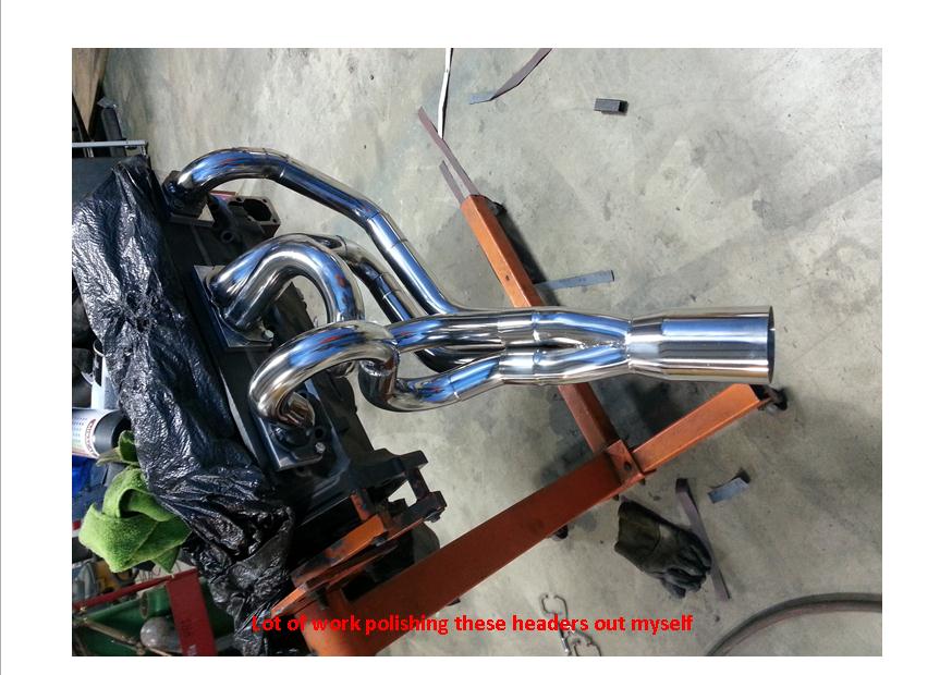

Default Re: C4 Corvette build for Superstock I-J-K

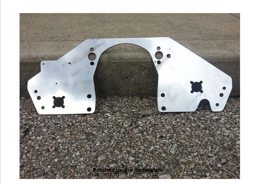

motorplate after polishing

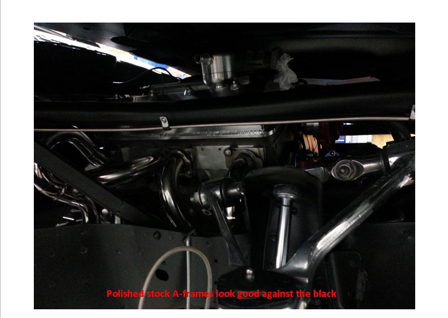

wheelie bar partially chromed
headers after I polished them
volt meter under gas door
single wheelie bar

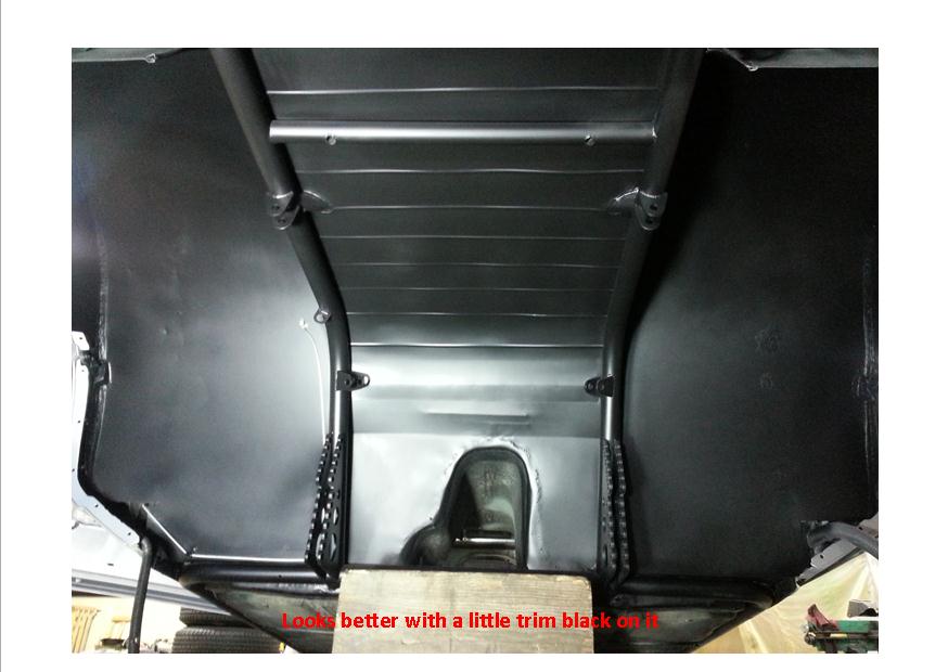

inside after trim blacked

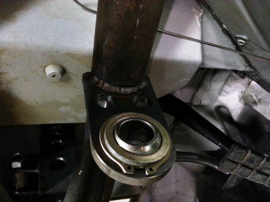

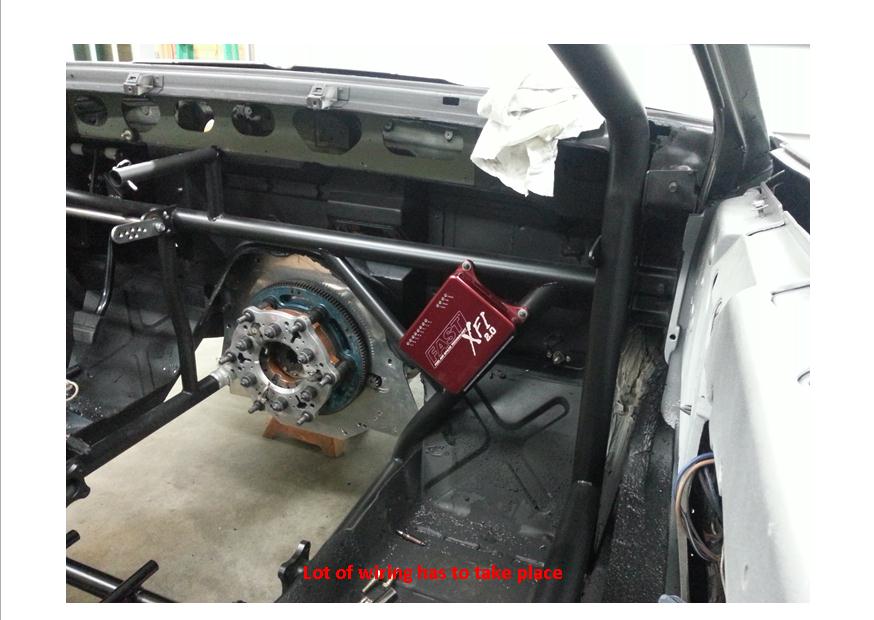

Ernie, great build I like the layout. Would you happen to have any pictures of the clutch linkage installed? I am thinking that you are using a bell crank under the floor pan or under the dash dropping down to the clutch fork?

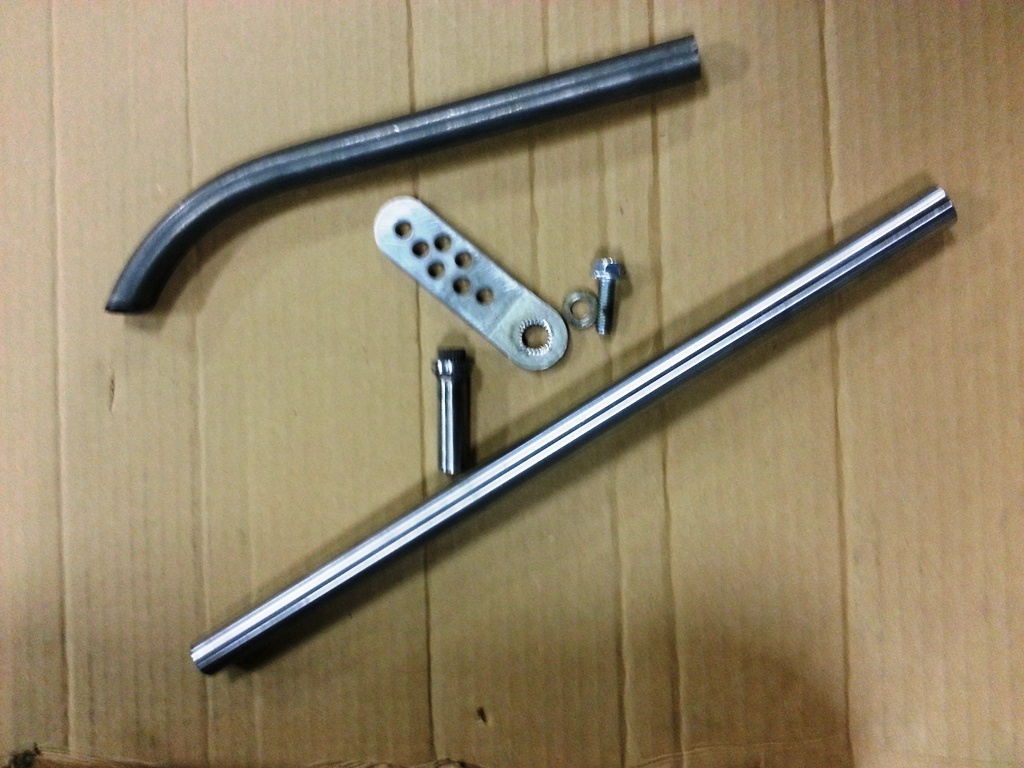

Robert,
my clutch linkage is inside the car similar to what old 55-57 Chevys were. I had 1 shot of one of the ends I made to hold the cross shaft. I used bearings on each end. These are welded to the dash bar. The rod drops through the floor just past the accelerator pedal.
The other picture is all the pieces that comprise the linkage before welding.
Ernie

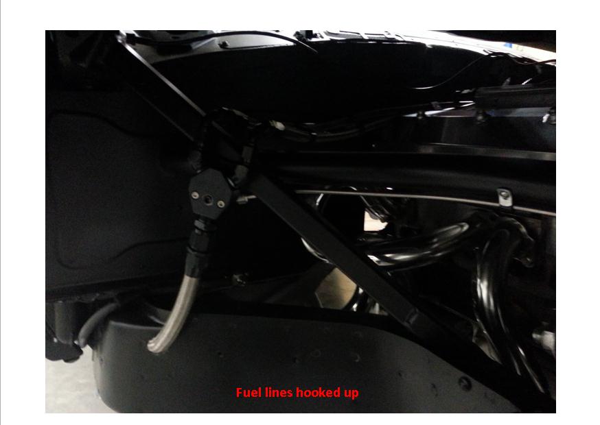

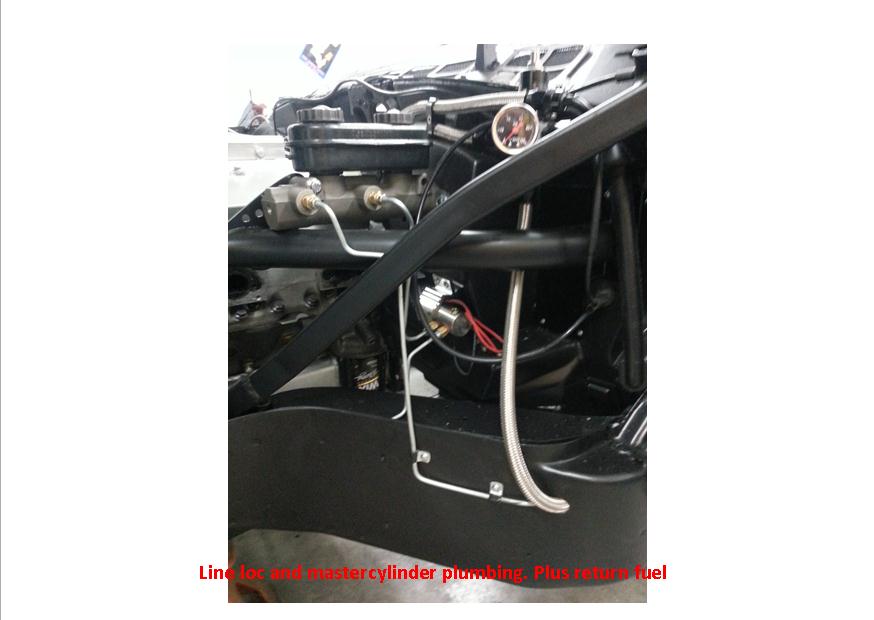

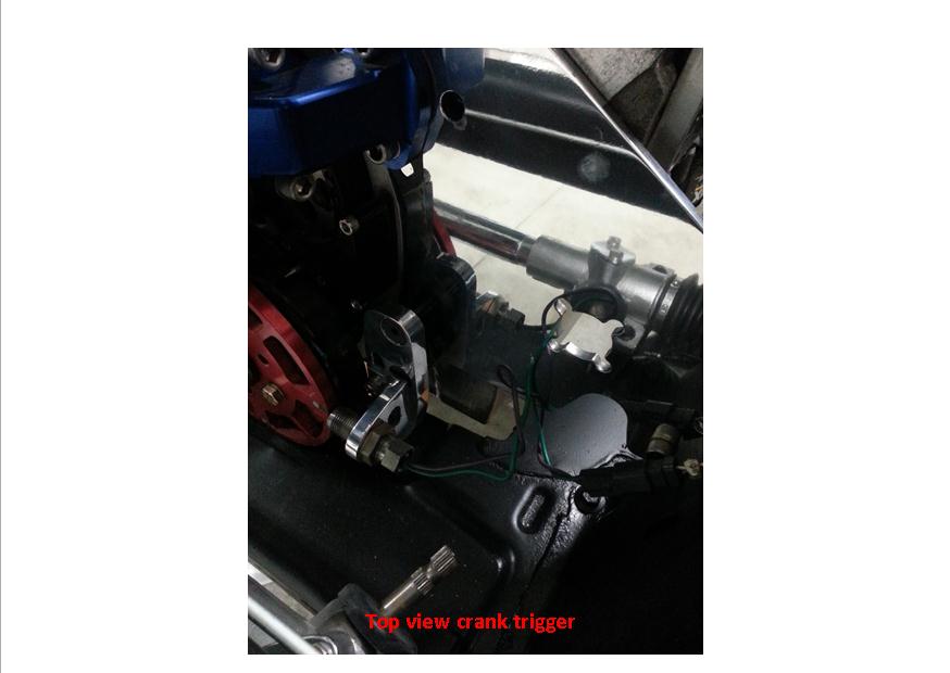

Well, these photos are mostly of final assembly of a lot of underhood components. Had to make that tight fitting cranktrigger bracket on the drivers side.
