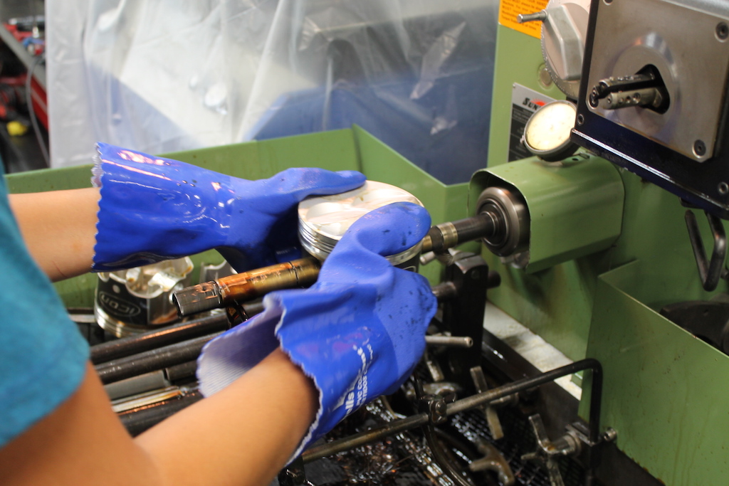

I got the pistons last week, Icon .040 -12.7 CC dome, they came in at 712 grams with pin after some work.

The finished piston. Some more pictures of sizing the wrist pins, size was set at .0008. I have to drill and tap the crank snout next and have the crank flange cut, then I can balance the assembly. My dad will hone the block then I can assemble the short block.
