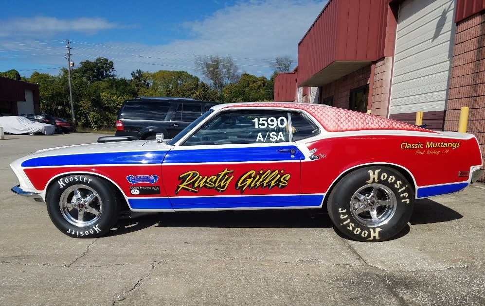

We made it to the 50th Cobra Jet Reunion on Thursday morning before they had all the tents set up.
My car was on display with other historic Cobra Jets
2018 Cobra Jet

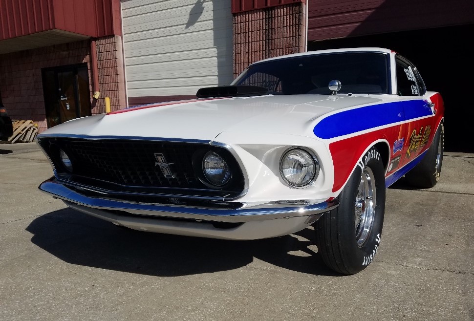

I decided to lower the rear it was way too high.
I've had a set of Calvert split mono leaf springs a long time I decided to see if they would work.
Looks a lot better now.

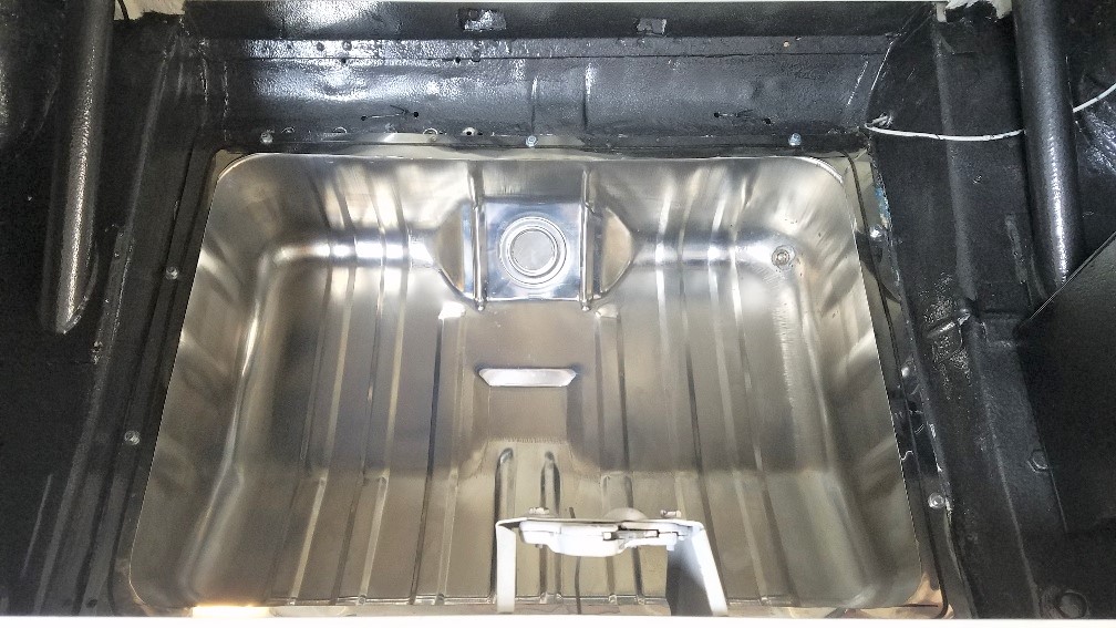

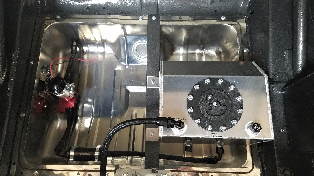

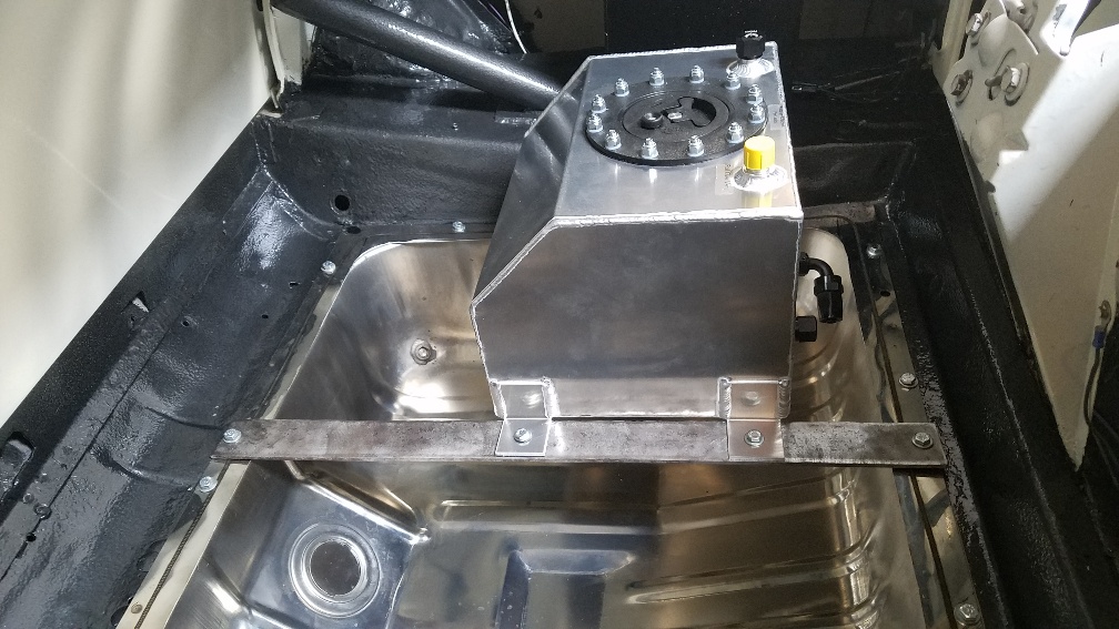

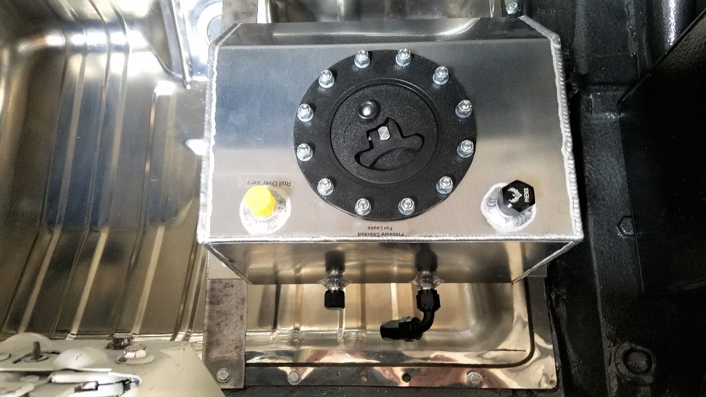

I wanted to replace the original stock tank with a fuel cell. I wanted the 4 gallon fuel cell, filter and pump inside the trunk. I came up with this idea of cutting the top out and mounting the bottom of the tank in the car so from the outside it looks original. We had a new stainless tank left over from another project so Brian cut out the top and used a piece to fill in the hole for the sending unit.
ID:	55295   Click image for larger version
ID:	55296   Click image for larger version
Rusty Gillis
Former NHRA SS/FA and SS/GA record holder
Rusty Gillis is offline   Reply With Quote

Not legal for NHRA stock eliminator
fredjohnston is offline   Reply With Quote
Old 08-17-2020, 08:11 AM   #50
Rusty Gillis
Rusty Gillis's Avatar
Posts: 260
Likes: 21
Liked 87 Times in 19 Posts
Default Re: 1969 Mustang race car that I have owned since 1970
Why isn't it legal?
It doesn't matter I don't think I will be racing in NHRA. I will race at NMCA or NMRA events in the future.
