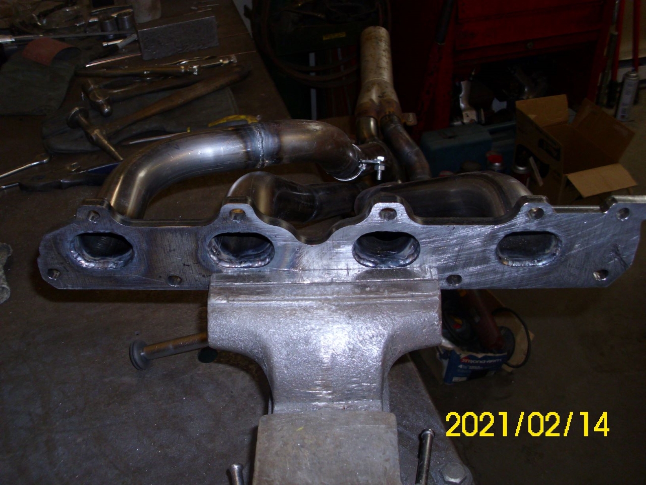

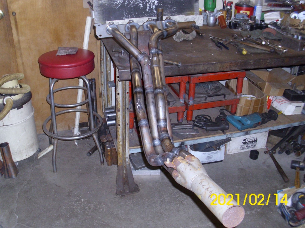

I got an update from Mr. Billy the other day with news that the header is done. He was unable to upload the pictures, so he sent them to me to see if I could get them uploaded, so here they are. Couple miscellaneous pictures of the car in here as well.
How long are the primary pipes?

35" and that's not the collector that I'll be using.
