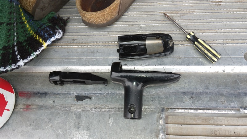

Loading the Luggage in the hatch of the car after it is on the trailer (at home still), I reach up to pull the hatch closed, and the Dodge Pentastar emblem comes off in my hand as I am closing the hatch, not broken, just some 2 sided tape will fix that next week.
Friday night, headed over for the 2nd and last pass after switching to FWD slicks, pull into the lanes, put it in park, and later as they pull us forward, I cannot get the car out of park. Oh sure, I changed the shifter cable, but have not found the Quarter Stick ratchet or B&M shifter in the (PRN321) pattern for the A413 TF yet that I am looking for, so if anyone has 1 hanging around doing nothing, and are willing to part with it for a reasonable price, and it is in good shape please give me a holler! (Thank you Greg Hogue in Texas, as he just recently pulled a shifter out of his 84' Daytona Turbo model that is the same type T-handle he is not using anymore for his FWD Stocker build, and is sending me a new (old) T-shifter handle).
And at least the button still worked, still had both park lock and the reverse lockout, so outside of the lane delay and looking foolish for a half hour or so, I could still race!
And lastly, after everything is over on Sunday, loading the car with things I will need in the future, as my car is "thanks to some fantastic & great friends" staying somewhat locally, & me moving a bit too fast around very old brittle plastic car parts...I break a seat belt Trim pc. on the passenger side (I have 2 now on the way already shipped to me via e-bay), but they are black and will get a coat or 2 of Gray paint to match the interior!
I call that highly embarrassing on the center 1 (that 1 happened not on track, or in the pits but as soon as I pulled into the lanes (and a lot of cars lined up behind me). Ever get your car stuck in Park, and you cannot get it out of Park? Try it holding people (it felt like everyone), up while they are pulling your lane (while many came to my aid, attempting to help rock it out of gear, we were fighting a losing war (the shifter handle broke inside, and the pcs I found out shortly were jamming the shifter Park/Reverse Lockout Detent Rod- but not pressing downward (just jammed on 2 sides).
